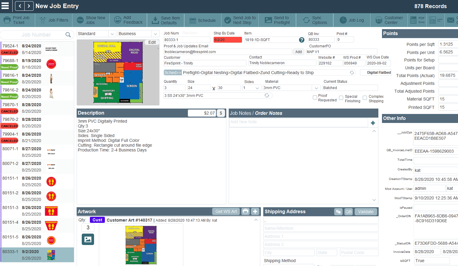

We call it Lumen internally. We just brainstormed the name. I didn't want to call it FileMaker as I figured we would have more than one solution over time and then it could get confusing.
As far as staff members, it's only me writing code, but I have a couple of people that help out immensely with bug testing, backups, server maintenance, gathering user input, etc. Our solution is too complex for others to work on it with me. It's is a beast by any FileMaker standard, but it's complexity comes from the fact that it's the only solution I have ever built. For example, the initial scripts that move data in and out of Quickbooks (We use enterprise) and our website were so poorly written I have rewritten them several times. What I know now vs. what I knew then are hugely different. This mess makes it really hard for others to jump in.
You start with "How do I make this work." and the first, and easiest way to make it work is what you go with.
Then you go to something like "How do I make this work without breaking every other time it runs"
Then "How do I make this work faster, even with more users..."
Then "How do I make this not only work faster when processing, but faster for the users to do what they need to do through efficient design." (Thank you Nick Hunter and RCC for your "Lean Filemaker" training on Youtube!)
The 5% is mostly for shipping. We are fully integrated with NRG Ship to allow for nearly "One Touch" shipping label printing. Users pick the job they are shipping and confirm the box size and weight (Lumen tries to calculate what that might be (we also calculate using OPS and pass that down the API). NRG prints the label for us and pushes the tracking numbers back into Lumen and from there our website. Our users stay within Lumen the whole time, NRG just works in the background.
Other than shipping, as I mentioned, I have a friend that was able to take the integration with QB and OPS and put all that into a mySQL database for me. This saved me time, especially at first, so we use that as well.
Version 1.0
Version 2.0
