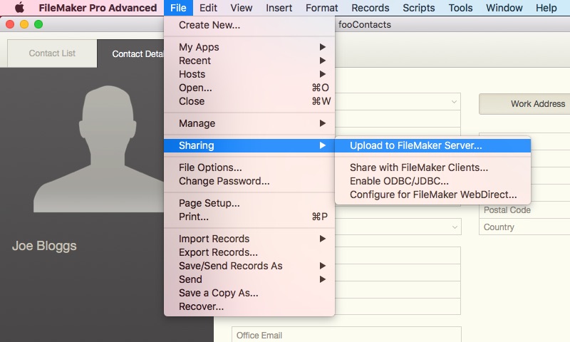

Can you build a single-user solution, then convert to cloud once it's all working properly?
No conversion is necessary. See the attached image. One would upload the work file to FileMaker Server which will run on Mac, Windows. (Unix is now in preview but has already been in service before, some years ago.)
Once the database file is uploaded, an admin will then make the file available to permitted users via the FileMaker Server admin console. Further development or changes can occur to the live file even while it's open and hosted. Devs often choose to do such work during off-hours but I'm guessing FireSprint works on his hosted file during work hours just as many in-house devs choose to do.

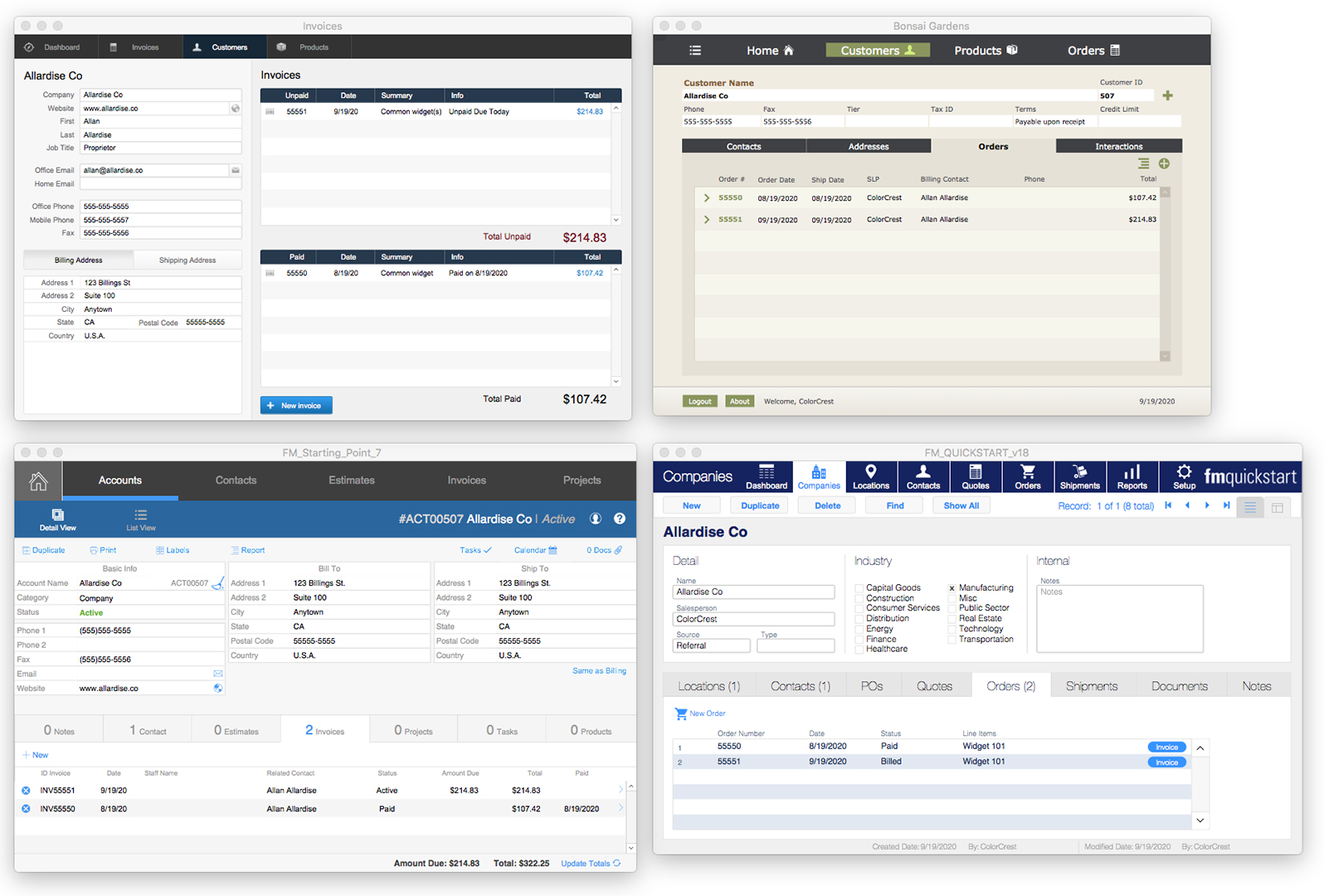

I'm going to find as many as I can to see how they all operate.
A collection of four CRM software layouts illustrating how different a user interface may be from one another but serve the same purpose, that is to show a particular customer’s invoices in this case. They all accomplish the goal but to varying degrees of advantage and effectiveness.
To study the variations is a practiced technique of “comparison” when inventing or developing creations, especially products for market, in order to discover opportunity for improvements.
Many sign layout artists are well suited to make software interfaces because it’s often more about “layout” than it is “design.”
