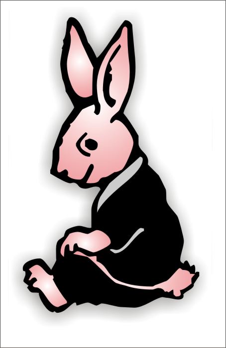

You would have to install the font.
Then go into Corel and type in the letter which corresponds to the character you want.
(use your charmap to find this or just hunt and peck)
Remember that if the character is a lower case Corel automatically converts the first letter typed to a capital, so you may have to type two letters.
Convert it to curves.
If the picture is really complex Corel freezes up sometimes (at least 9 did)
Then in wireframe assign colors for print or just combine it for cut vynull.
Here's a quickie from a dingbat font.
This is rough looking, and obviously not for logo work.
But for a quickie lickie sticky, it can add some fun.
Love.....Jill
