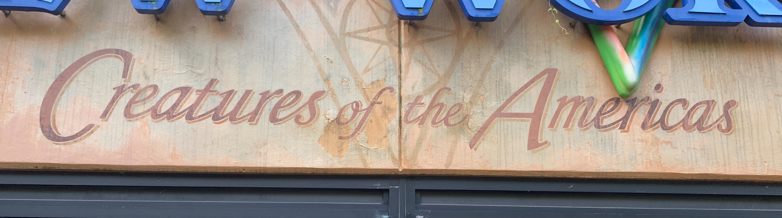

we've been hired to repaint this exhibit at a zoo in Nashville but they have no record of the font used as it was a loooong time ago
O1OO1O11
zoo would prefer us to use the same font if we can find it. free or commercial makes no difference. the original artwork is pretty old but i do believe they used an actual font for the design.
i've ran it through several reverse font engines with no luck. thought i'd try some forums.

Hate to break this to ya, but while there might be a font similar, that was hand-painted. All 4 'e's are different, the 'r's, the 's's and the 'a's are different. The keep-away shadow is all different, too. To me, it looks like someone who had good command of off-the-brush capabilities and executed rather well.
ProSignTN

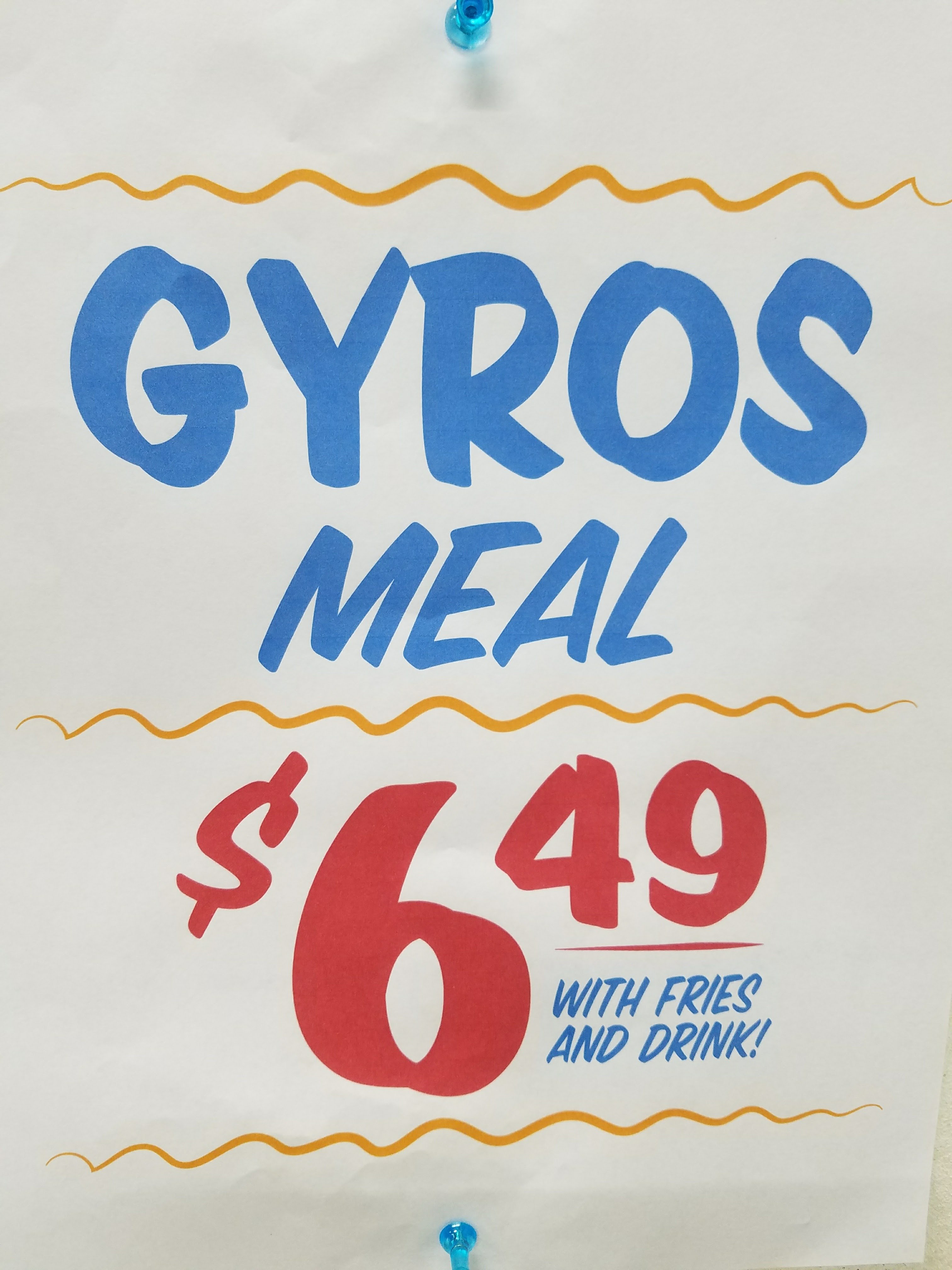

Gino, you mean those butcher paper signs we used to see in all of the grocery stores? Something like... this?
(At a previous job, I thought we'd try to bring this kind of sign back for nostalgic purposes, but only I enjoyed the idea... This wasn't painted, though -- all fonts and mirrors).
Haa...... yeah, that's the same concept. Looks kinda hand-done, but you can see the fonts, like you mentioned and the squigglies are identical, just turned upside down and reversed.
That's a really small sign, judging buy the pushpins, I highly doubt anyone would've done that by brush. Maybe a 1/4 and some speedball action.
