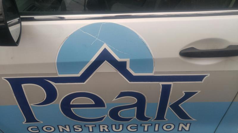

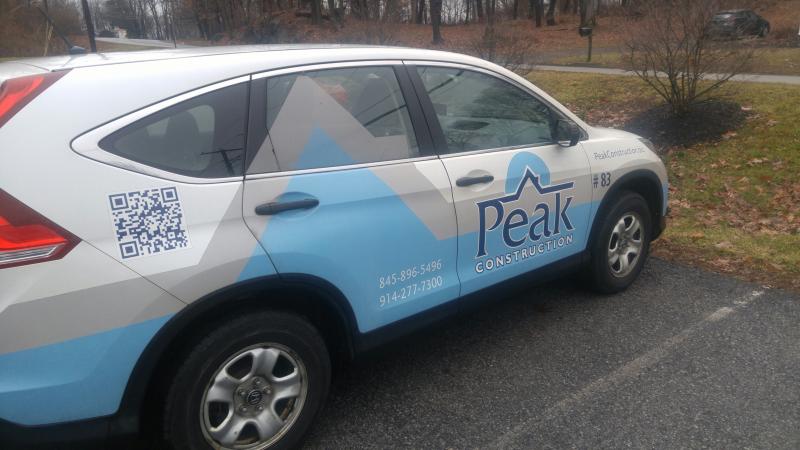

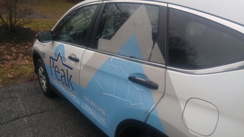

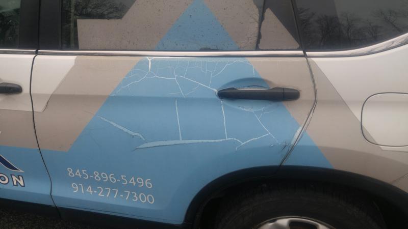

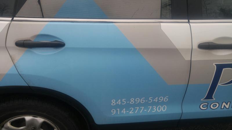

This partial wrap is 4 years old. We used Oracal 3751 with 290 Laminate. Both sides of the vehicle were printed and installed from the same rolls of materials. Installed using the same technique. Driver's side is wrecked, passenger side looks like normal wear-n-tear after 4 years. Anybody got any ideas as to what caused this?

I'd hazard a guess that based on the material used and not knowing the region, stress cracks due to over stretching on that side along with excessive sun exposure. If that vehicle is parked in the same way everyday and sees a lot of sun, I'd believe it.
3751
eahicks
Is that window perf on the glass or the same vinyl? Seeing how tore up that part is too, I'd say overexposure to sun. What happens if the car never moves or parks the same way every day.

This is the first vehicle we've had this happen to. Is this typical of sun overexposure after 4 years? Our own shop van is wrapped and parked in the same place day-in-day-out and it doesn't show this kind of wear. And it's wrap is 12-18 months older.

The logo on the door is an overlay of printed, laminated and diecut using the same material as the rest. The grey and light blue are a solid print with lam. There is perf on the window.

not sure how probable, as i'm in california with extremely harsh winters (...) but maybe some water/rain got in underneath the vinyl and never got out when winter came and turned it into ice? kinda like how pipes crack... i've had to replace wall graphics that had water fill up between the wall and the adhesive, material looked similar to that.

I am with team exposure, the left side must be getting much more sun than the right with both the regular print material & the window perf failing on one side only.

Don't use Oracal much but ave you asked the client how often they wash the vehicle? What they use as a soap? Did they use a pressure washer? Did they try to wax the vehicle with some type of buffer?
As far a the layered material coming up, we have found that in colder climates, when placing a second layer on top of a gloss laminate that as the car expands and constricts it has a better chance of curling on the edges and doing things that look very similar to what you have.
Also it looks like the the rear doors on the driver side gets used more than the other side, so perhaps someone is resting something on it or brushing up that is causing it ware down....
