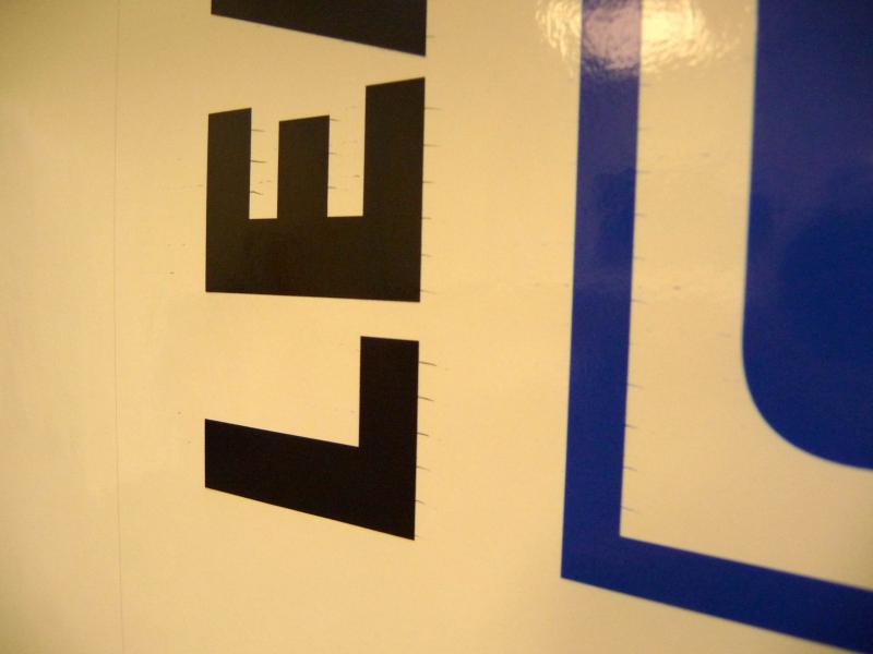

This is being printed on a HPL26500 with Briteline 2203 and doesn't really look like headstrikes. I tried increasing the vacuum pressure but that didn't seem to help. It also happens on good vinyls like 3m IJ 180 but not as much. Any help would be appreciated. For reference that L is about 2'' tall and the picture is configured so that the bottom of the picture is heading toward the take up reel.
