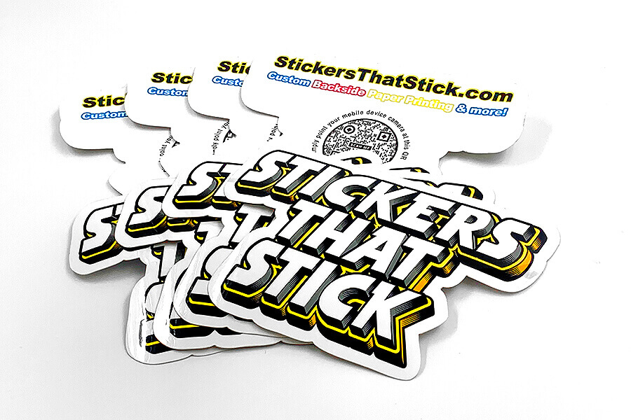

i would like to produce a few hundred stickers, they also should have a print on the backside so they can be used as buisness card..
what is the matieral called where the stickers are sticking on??? release liner? backpaper?
most times it already has a print on it where it says for example oracal... can u just print on this side with eco or uv???
is there also one wich is blank??
i only was able find stickerapp wich are doing backprints...
i was wondering what i need to look for to find more shops who does this?
i got my file set up and mirrord everyhting so the file aint the problem finding somebody who can do for normal price is...

i dont want to reply to every answer directly... i said i found a few shops which are doing them but they are very expensive... stickerapp for example does them thats where the pic is from!

i added a pciture of what i want.. i want sticker and it also should be printed on the paper back side...

i dont want the sticky side printed... i want the back of the backing printed the side where its normal paper... where it normaly says oracal etc... so after pulling the sticker off, the backing still can be used as business card ...

You'd think... We've tried a bunch with our latex and the ink just wipes off. It's a weirdly coated paper :(
Our solvent doesn't do double sided but when we tried to print on the back it worked the best. UV also works, but can run off if you don't let it cure for a day or two... And we were just printing text, so I imagine a full print wouldn't work too well.
Obviously every material / backer would be diff... We tried oracal and Avery and a no name brand.
Most of our back sided prints are screenprinted... Works the best but obviously very limited if you don't do high quantities.
I tried for fun and sure enough the backer is just too waxy to hold the ink.
I believe most digital processes won't work on the backside of release liner, in an attempt to make sure other companies don't misrepresent themselves.
