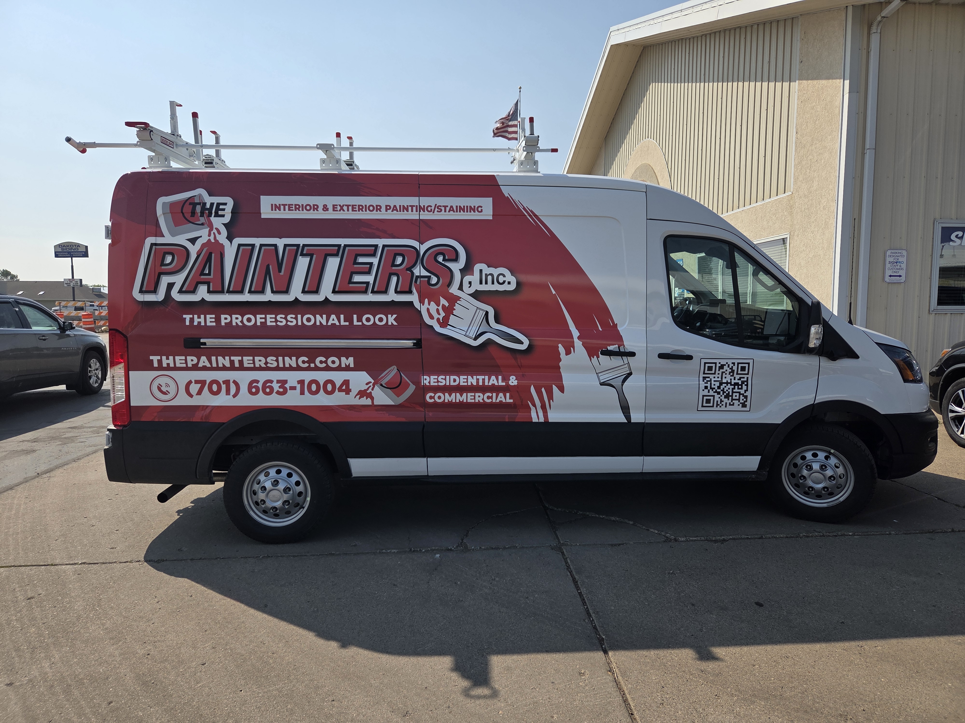

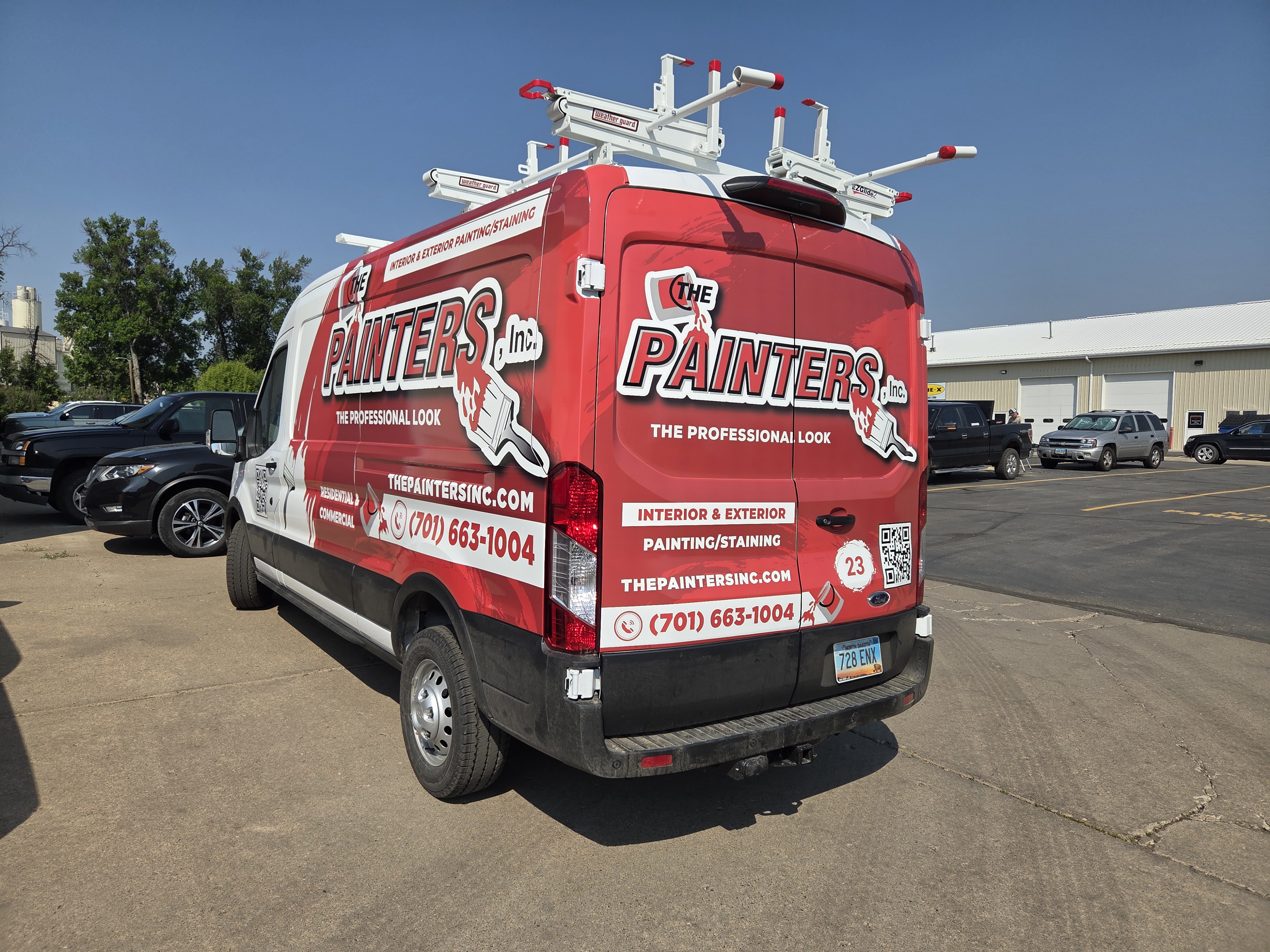

Carol Sundberg
Thanks for the input. I appreciate your perspectives. I don't think we've always been as clear with our customers upfront as we should be. We know the limitations & expectations; it's second nature to us. I think we sometimes forget that not everyone knows what we know. I always tell my employees that it's our responsibility to educate our customers, not just sell them signs. Your words will make the conversations with this & future customers easier & more informative.
This is the final result. I'll see if we have any pics of the "flaws".

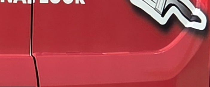

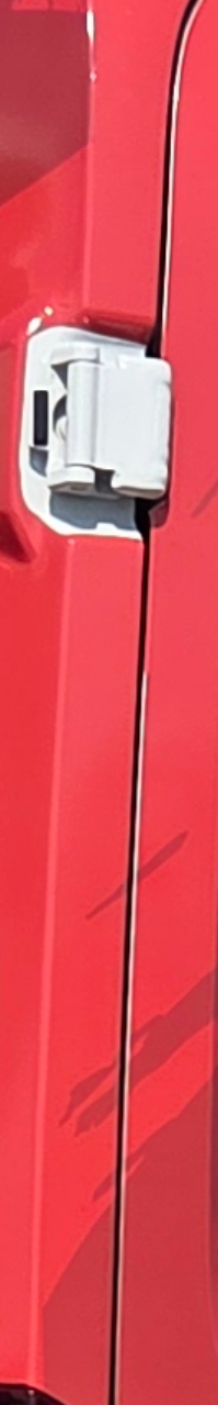

ikarasu
I'd worry about this if these are bubbles... Sprinter vans and that big recess is hard, But such huge bubbles like that will only lift more, and within a few months it'll crack and look like garbage from 20 FT away.
Other than the above bubbles, which seems to be on most of the areas like that (But could just be a photo?) It's not something I'd complain about.
Personally I don't see why This wasnt wrapped around the door so you don't see white... Unless its just the sun and the photo is deceiving? Looks like this in a few spots.
Some of the text is landing in bad spots, and would be much better shifted over slightly... But again, most of this is just nitpicky things that very often get overlooked, and while having them done would be nice and set you apart from other shops... are more than acceptable on a fleet vehicle thats not a full color change. The only thing I'd say they have a right to complain about is the bubbles / lifting in the crevice, unless the photos just deceiving.

GAC05
Quit buggin' me
I agree with Ik, lifting in those channels is going to get worse with time (at least from what I have seen using 3MIJ180cv3 and 9519 luster). Even with a reprint they are more than likely to lift again. Some shops cut and drop and then reprint the strips to fill the gaps. You could clean up what you have now & reprint just the strips with some clean straight overlaps.
You'll have to do more than just the failing areas to make it look consistent and not a last-minute cut-and-patch job. It'd be a hard sell with the guy already looking for flaws. But if more lift, you will be back to square one with the customer anyway.

It is so easy to critique our work or someone else's work after the job is done. Overall, your application looks good.
The only area I see really needing improvement is the passenger side rear door because in addition to the pocket of crease bubbles, it looks like that panel got shifted up to the right which left the top alignment okay, but about midways the word LOOK is higher than lettering on the other door. And the stripe with the paint bucket by the phone # really looks off. This is something that the painter's prospective clients (and ours) might easily spot and multiplies unfavorable impressions by folks who might ask, "Who did your wrap?"
The little section of roof bead on the upper right corner would benefit from a quick straight line cut, also.
The lifting in the channels is going to happen no matter what you do. It's a Sprinter with an EXTREMELY deep recess. I usually tell the customer that I am going to make a relief cut for the recess because no matter what, it's going to come up. Vinyl is flexible, but it has a memory. The recess will should between 1/8" to 1/4" of white.
As for the back door hinges, I agree. Your staff should cut right up at the hinge. The only white that should be seen is the hinge itself.
