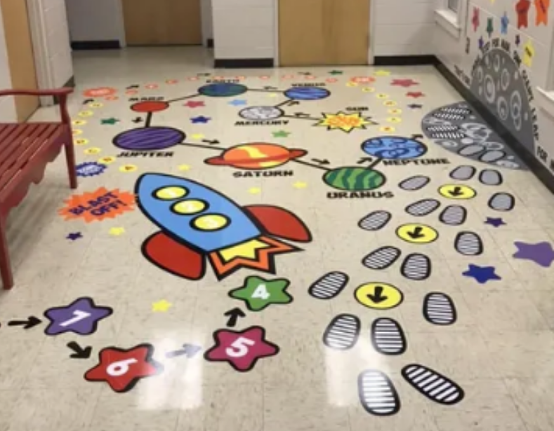

I'm volunteering to print out approx 170 sq feet of floor graphics for a sensory path my kids elementary school
I can either use my old epson 9600 printer or pay a photolab to print out all the images. I was considering 40C-20R by 3m but it's only available in 54" rolls ( 2x more than what we need) Here are my questions:
how long can one reasonably expect these to last with kids stepping on them every day?
What is best overlaminate and should the overlaminate be a little bigger around the image to "seal the edges" to the smooth tile floor?
My research says 3m 8509 luster will last longest, is there a better material?
What pressure sensitive adhesive should be used on back of prints? or is there a spray or roll on solution that works well?
Will I regret not using 40C-20R by 3m. My logic is the overlaminate protects the image so the actual material the printed image is on is not that important. Suggestions for less expensive alternative for 40C-20R by 3m that will work with epson pigment inks also appreciated. Only one I could find is https://www.lexjet.com/lexjet-extreme-aquavinyl-w-psa
but I'm worried about the lexjet material because it says adhesive is permant after one year. I dont' want the school cussign me out 3 years latter when they try to remove the graphics!
