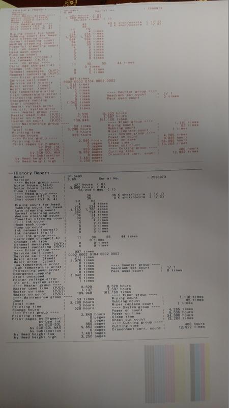

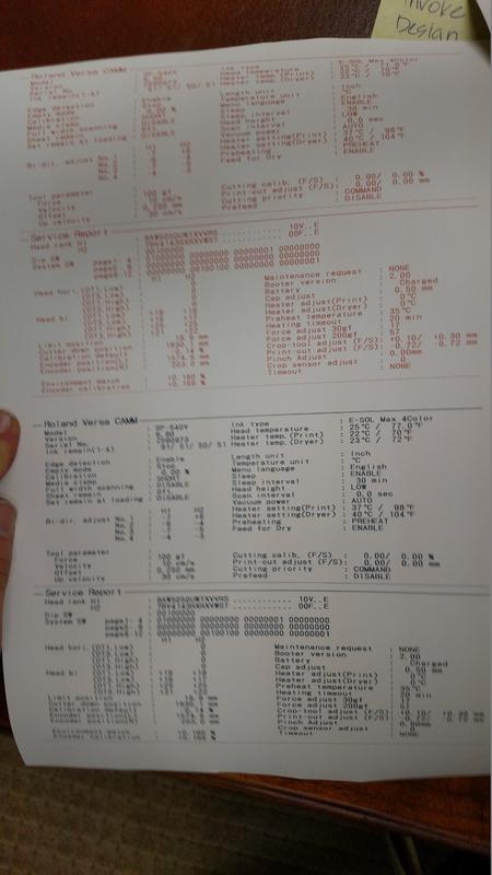

I just got the history from the machine i am looking at. What are your thoughts on this history report? is this alot of use? if so, where can i find other used machines that could be a bang for the $? I appreciate all the help guys.

I bought my SP540V for 6K a few months ago in excellent working condition. I contacted my printer service tech and they found it for me and checked it out before I bought it. John
player
I think 3,500 hours is way too many. You should look for a newer model with under 500 hours. They are still very cheap. I also agree about getting a separate cutter. The registration of the print cut machine won't be as accurate as a separate quality cutter.
