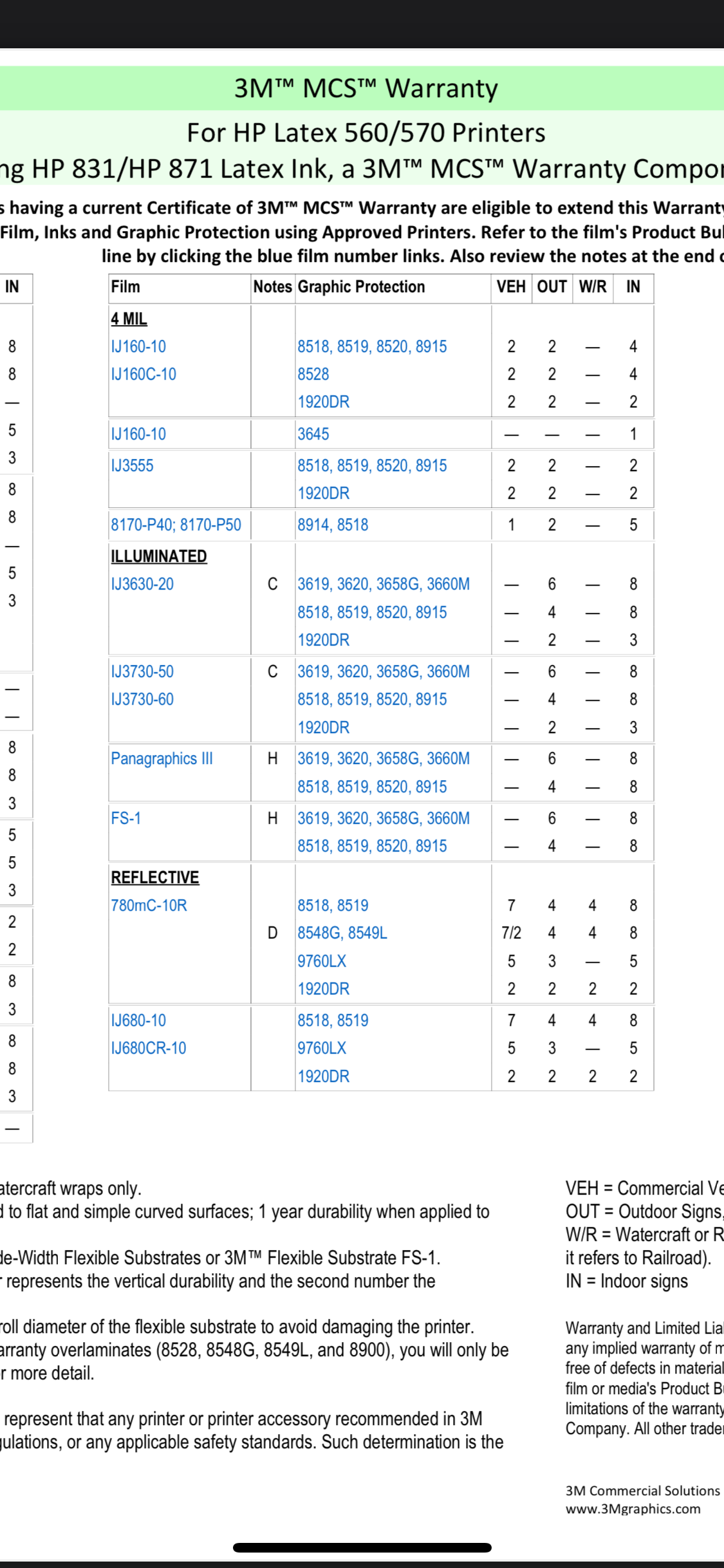

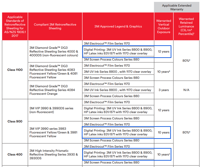

Let me see where on 3Ms MCS warranty that they say 10years! I don’t have mine in front of me but I HIGHLY doubt they say that. I could be wrong. I carry a 3M MCS Warranty and don’t recall anything that high.

https://multimedia.3m.com/mws/media...ssories-for-traffic-sign-production-flyer.pdf on my.phone so I can't find it. Above it says "up to 12". Diamond grade is 12... And I believe the rest is 10.
IIRC, the warranty is higher for digital than it is for screens... But I haven't looked at screen printing warranty for awhile.
Here you go...
