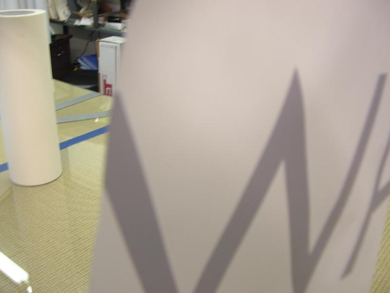

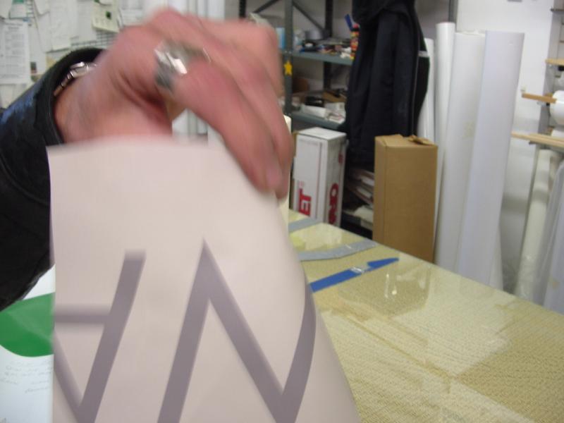

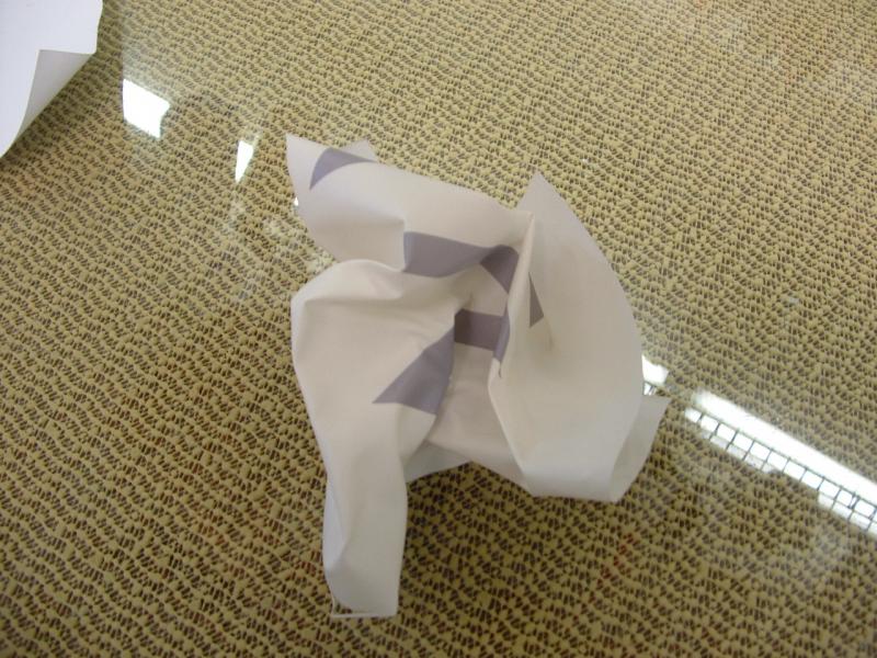

Anyone have any idea of what this vinyl is.
It looks to me like some type of polyester or fabric. It can be printed on, or at least sublimated. Color looks to be an off-white
The attraction is that it can be scrunched up and allow the the glue sides touch each other and then flattened out again without hardly a wrinkle.

phototex/walltex/graphitex/lots of em
are woven polyester textiles
there's also versions with a PVC face but still has the same "ultra-removeable/reposisionable" adhesive. like FatHeads/JarHeads/etc.
