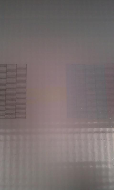

What might cause the attached picture? (yellow is not firing 100% after a normal cleaning comes back)
Well, after a normal cleaning black is gone. (picture 334)

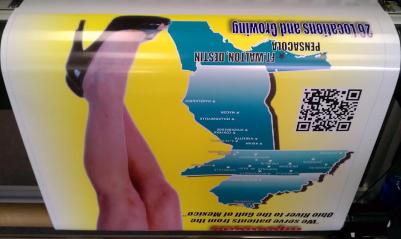

It did it while it's printing attached picture 333.
Any comment is welcome.
Thanks in advance.

MikePro
ink supply/refresh issues.
could either be a capping station that's not making a proper seal or an air bubble/leak somewhere above the head or a clog below the capping station or an ink pump on its last legs.
i lose my colors sometimes after a nozzle wash, because the printer doesn't try to refresh the heads all the time before doing a test draw right afterwards. try doing a disway wash after your nozzle wash and the printer will try to cycle ink before doing a test draw.

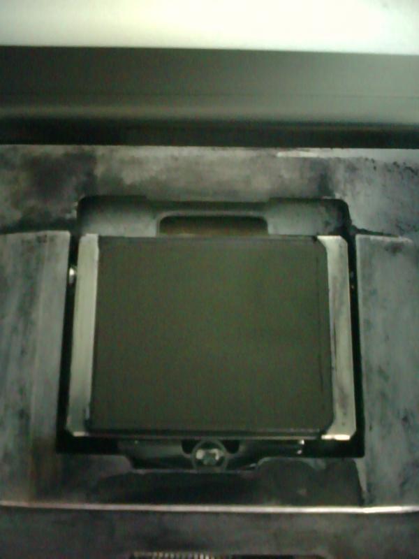

Attached picture of capping station position on the head. left mark is right near by the stainless steal frame.

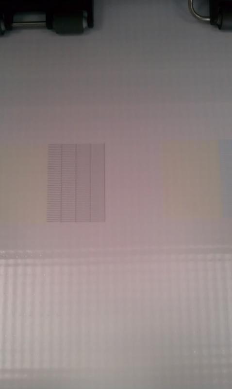

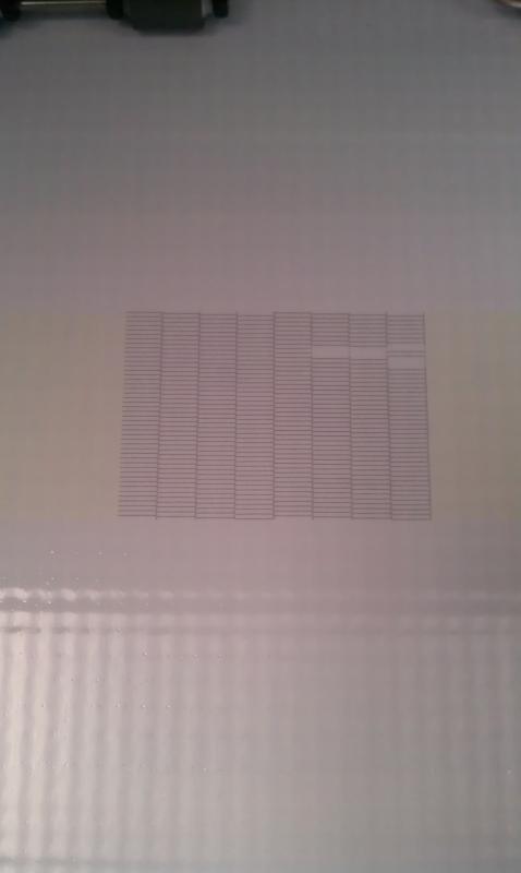

Attached picture 335 is the after the 3rd normal cleaning however if you look at the picture 332 which is the 1st test draw after I noticed something is going on with yellow (same picture when I started this thread).
