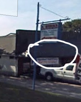

Need more information and a snapshot of the existing hardware and what the hanger looks like. Ya need to know what the hanger will be capable of holding, weight-wise. Did you check with codes and find out if you can do the same thing over ?? If codes changed while the other one was up, it would be grandfathered in, but replacing the sign entirely might not meet code, any longer. Ask me how I know. :wink:

Definitely need to know if the structure is still capable of handling it.
That is really large for a swinging sign.
I build swinging signs heavy, you want them to move, but not whip around in the ind.

It will hold as it's holding a backlit sign box 4x4' above this sign currently also.
Quick snap from google street view.
What substrate you guys think would be best and thickness? .080 isn't thick but it has some weight to it...Vendor is telling me 3mm dibond would be fine but I'm not convinced (grimco)
1/2" MDO. Aluminum composite will either warp or fly around too much.....even 6mm. 10mm, ya might as well go MDO.

I highly suggest using Lusterboard (aluminum on both sides and 1/2" wood in the middle) you can also get it in 3/4". It's great for blade signs and hanging signs. Also since I haven't seen it warp, it is heavy and won't blow like crazy in the wind.
dibond is very light and it'll flip up and damage the sign. Lusterboard is heavy and it will still swing just not as much.
