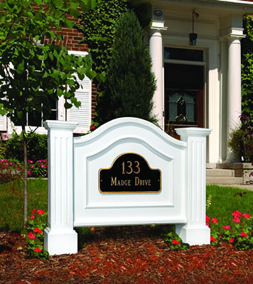

A guy sends me this link: http://www.gomayne.com/products/address-signs/nantucket.html
He's already bought the stand or monument (or whatever the correct term would be) and wants a sign to go in the middle. He's thinking something with routed text with a goldleaf look. He's putting it in front of his dentist office.
Any other suggestions on what type of sign would look nice? Sandblasted? I don't usually get into this area of signs so I'm not sure what options are out there.
The total size of the sign will be approx 11.5" tall x 17" wide.
Thoughts?

or have some pvc routed. Im all about routed pvc, we dont do much sandblasting down here anymore as most companies route
