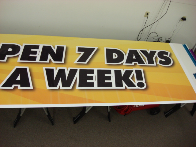

Could not agree more ... but my banner just came out using the manufacture advised profile with the same result ...
I have the same printer ... but did not use the blockout profile. She told me on the phone to use the General PVC Banner profile ...
My results are below ...
See the white "streaks" ... :help:
