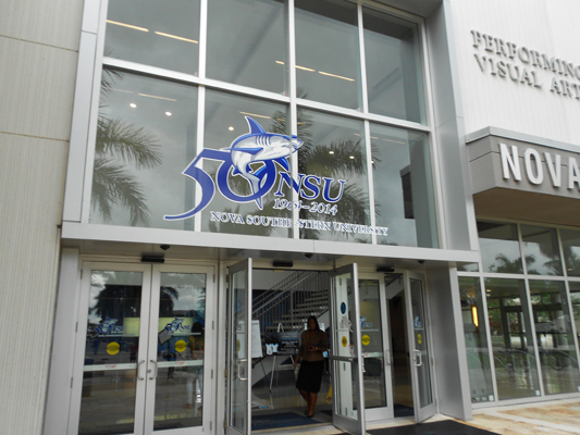

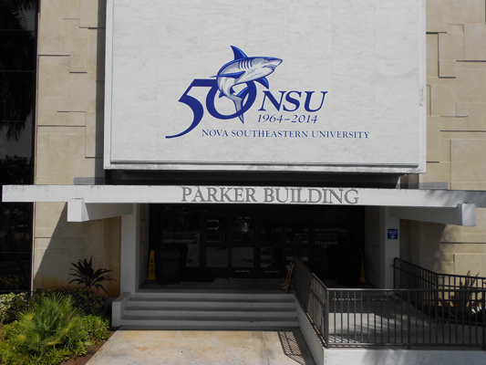

We use phototex all the time on exterior walls. I don't have a pic here but we also did a wall in a gym that is 20' X 15' with 60" phototex paneled. it works out great and the client can just rip it down when it is not relevant anymore. it also works well on buses for temp adverts and alum or fiberglass tail gates as a temp sign
