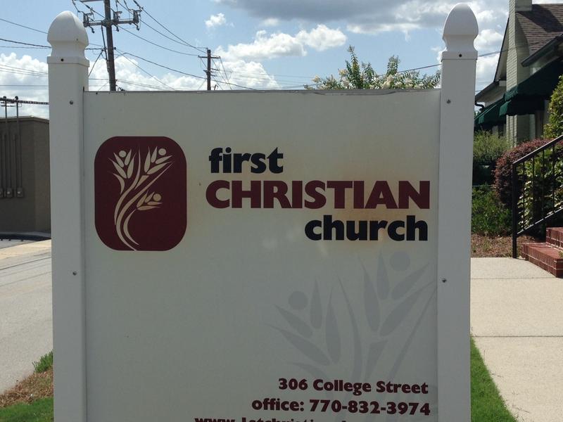

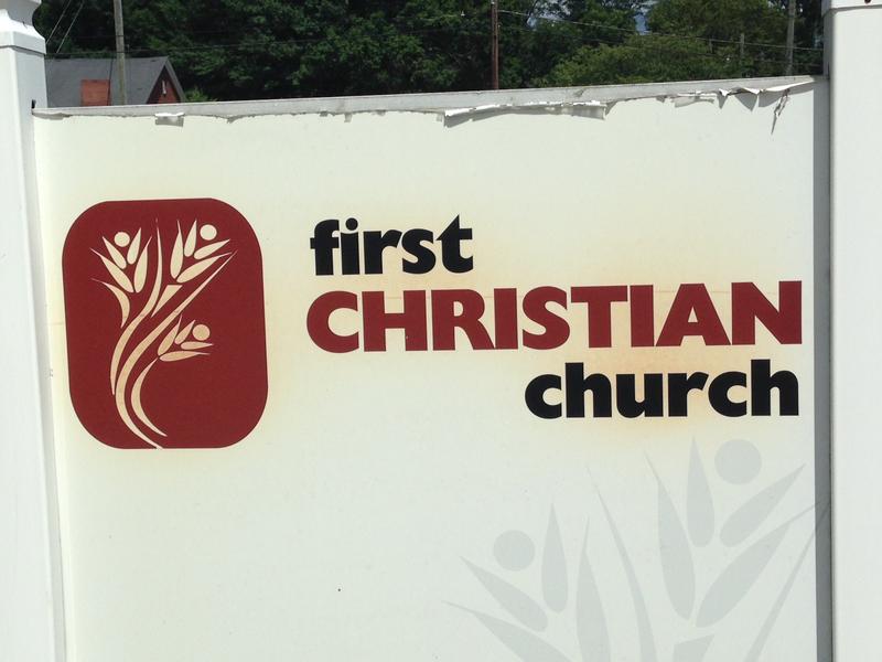

Some other company in our area is using a print vinyl that is "burning".
I have seen this several times where around the printed copy/graphic the vinyl turns brown or almost black.
What kind of vinyl/method would cause this. These cant be that old, maybe less than a year.

Looks like someone is slowly torching the signs. Why isn't it happening to the stuff down below ?? Very inconsistent, at best. I'd call them, ask the company who made it what they're using and steer clear of it.

Years ago I saw this on some LG printed vinyl - really cheap stuff - can't remember what series. That's been about 8 or 9 years back, so not sure if it is that material or another on your sign.

Judging by the looks and our luck we've had with it, it is probably Instant One Media Calendered. The cast is ok, but the calendered shrinks/browns. JUNK

regarding the OP, yes we have seen this more than once and it is usually the lamination that does it. especially when a non UV treated / indoor lamination is used.
The curling from the edge is a major indication of either a very cheap vinyl was used or a substrate that was not intended for graphics.
Either way, looks like a hack job if it is less than a year old.

I see that phenomenon in our area all the time. My guess is that it takes at least four or five years to occur, but I haven't been here long enough to put a timeline to it. We are in an area of intense UV and 320-340 full sun days per year, but not any higher than AZ I would imagine.
I see it frequently on coroplast signs, as if the process of the coroplast deteriorating is also eating up the media from the backside.
My guess is its cheap calendared vinyl laminated with either cheap or mismatched laminate.

I've seen that happen to signs we've printed... So go quicker than others, I think it depends on how much direct sun the signs see. It's not the vinyl though, its the laminate... We laminate with Oracal 210. We re-printed a sign that was around 4 years old, it was in direct sun all day, and when we replace it, it was "burnt" completely black. You couldn't read any text, but we started picking at the laminate and found that underneath the burnt lam the ink was still in good shape, not even that faded...

It's the laminate not the vinyl. I've just about given up laminating anything with vinyl laminate because of this. Of course I'm a mile closer to the sun than the most of you flatlanders and the UV is far more intense at these altitudes. Unless the product is going to see an excessive amount of violence I'll coat it with Clear Shield liquid laminate. It has every bit as much UV resistance and doesn't discolor.
Case in point: On my truck the tailgate is wrapped in a print and there's three printed panes on the hood. These prints have been on the truck for ~5 years. The tailgate print is laminated withe Oracal 290 and the prints on the hood are coated with Clear Shield classic [nee original formula]. The tailgate is starting to discolor but the prints on the hood look just like the day I applied them. Except for the scratch where a horse I was riding decided to scratch his chin and dragged the shank of his bit across one of the panels. Even laminate wouldn't have fared well with that treatment.
