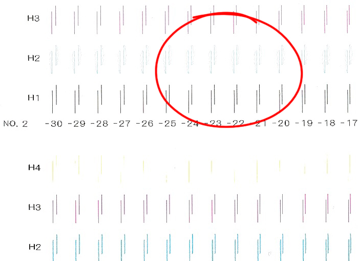

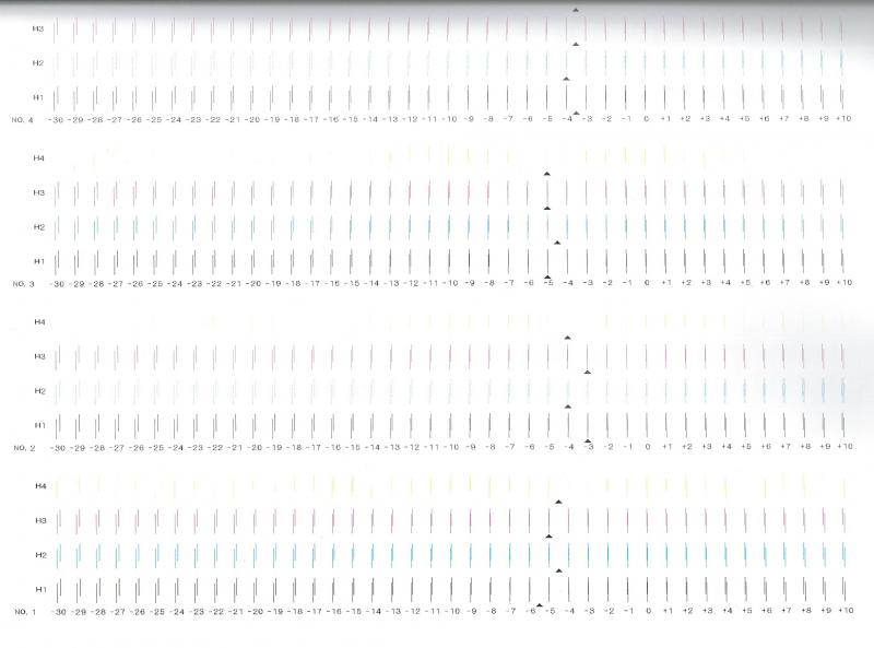

I have been getting some fuzziness around whatever prints blue. This is what I found when I did a detailed bi-directional adjustment test print. Everything else works perfectly and the test prints are perfect. Reading the Roland site, it says number 2 and 4 are the "smaller" dot pattern prints. As you will see on the pics, on #2 and #4, there is a faint fuzzy line around the cyan print.
I am using a 2 year old Roland VP-540.

I my opinion, I think the Cyan print-head si dying. Might be that (the cyan is fading in the adjust bi-dir test) or you have some "rebel" nozzles(misfireing).
You are printing with the head hight on "high" position? Try to switch on "low" especially for vinyl.
Most probably, you print-head is kind of old now. This blurry "thing" is going to get worse in time. You will be forced to change the print-head.
Hope that helps!

I have five year old heads that print fine on mine and I use them about 8 hours a day and five days a week. Go into service mode and do a horizontal head adjust test print, re-calibrate it accordingly and it should clear things up.
Letterbox Mike
Nozzle deflection. What does your test pattern look like? More than likely you need to do a good custody wash (or head soak or whatever you Roland people call it). This is caused by ink spraying at an angle instead of straight down, usually just because there's some small buildup or gunk blocking the nozzles. It can also be caused by a damaged nozzle plate so try to visually inspect it to make sure it's not scratched or dented. That's rare though, like I said, it's probably just dirty.

If you can get in service mode and run a fill pattern. If you see overspray on both ends of your cyan print then you have a bad printhead. You would also see a halo effect or overspray in most of your prints.
