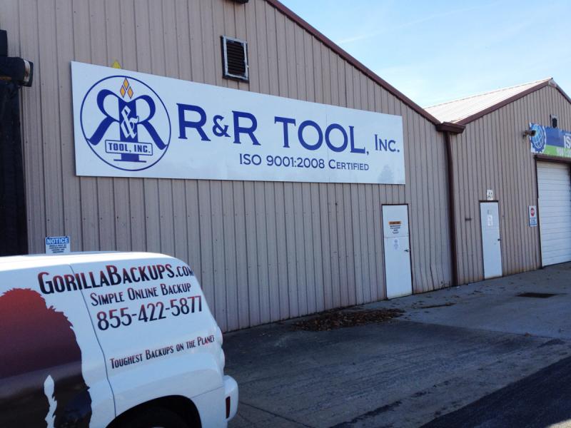

Just finished this one a couple moths ago. Make SURE your screws are hitting studs, or add studs before you place the panels. This one is 5x24 (3 5x8 panels). I am pretty sure this was the thinner dibond/alumacore/etc/etc material.
I think the colored sheets are "single-sided" one color and a different color on the other side. (like red panels have a green back, vice versa) i've always just bought white panels. Seems like everyone wants the 5' tall sheets anymore though...
