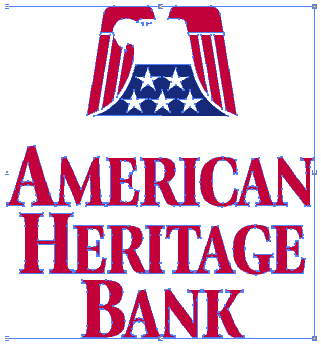

I should probably know how to do this, but I don't, so I am asking a huge favor.
My customer sent me this Adobe Illustrator file that I need to make some minor changes to, but everything was grouped together.
I went to Object>Ungroup and clicked it, but nothing changed. I went back to Ungroup and I could no longer click it.
Is there another way?
Thanks!
***NEVERMIND*** I PLAYED WITH IT A BIT MORE AND I FIGURED IT OUT ***THANKS ANYWAYS***

its a mask most probably and if you dont have an unmask option you could try breaking the path. Be careful though as when you break apart masks, sometimes the image can change or pieces get deleted.
MariaMartini
Thanks for the help guys! I think I did the unmask thing, worked great except a few letters split in two, but thanks to you'all on the forum, I learned how to fix that on a previous post.

Guess it was the compound path =)
Deaton Design
Its under object=compound path=release. If you release the path, some letters with centers will fill in. Just select that letter and go to make compound path, and that will fix it.
