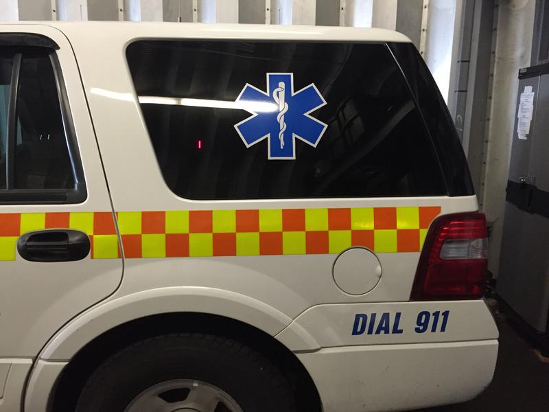

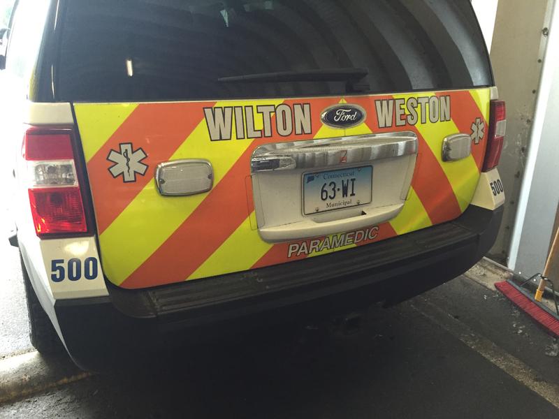

Need to reproduce these graphics. Fluorescent yellow with Fluorescent orange/Red High Intensity. Looks as though the orange is overlaid at factory not by installer? I would settle for Stripes and will cut squares if I have to and over lay after.
Looking for US Supplier

It appears to be just printed on your choice of reflective vinyl. That is the easiest/cleanest option.Edited to add: You can get the fluorescent yellow diamond grade vinyl, and overlay transparent red vinyl to get the same effect. This method is also approved by the NFPA.
