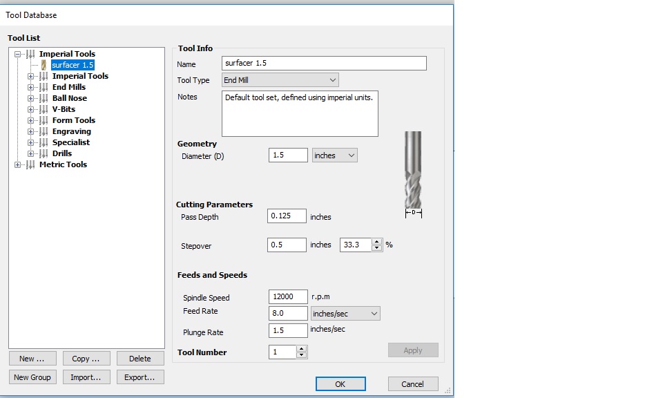

I understand how to do that part. I am looking for the parameters of the tool I am using, there isn't a DXF file I can use so I need to know what the specs are to input into the new tool profile.

This is what mine looks like
