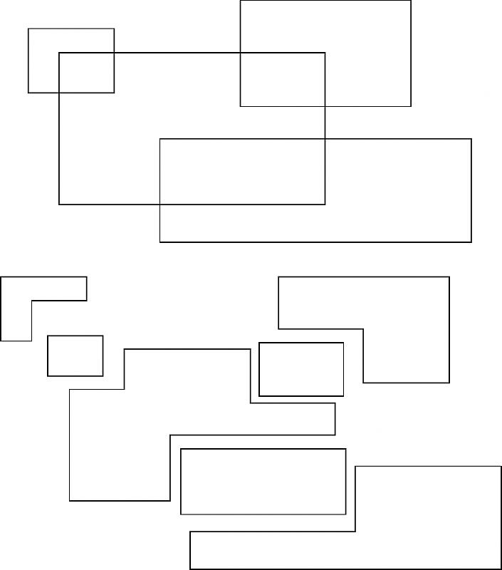

edit: picture for reference: up top is four objects. Select all > Divide gives you all the objects underneath. (I "exploded" them so you can see all the objects)

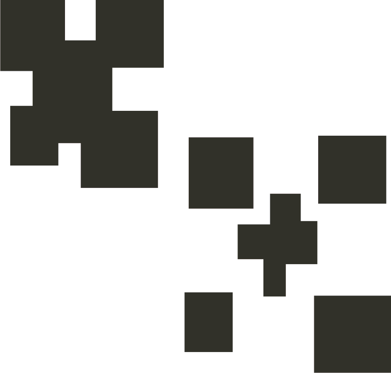

Trim isn't what I need. I want all the objects to cut each other, and leave the rest of the objects.
Trim takes five objects and leaves you five objects. Divide will take five objects and leave you with 9 if you have four overlaps.
This is what trim does for me in corel. (and illustrator)
