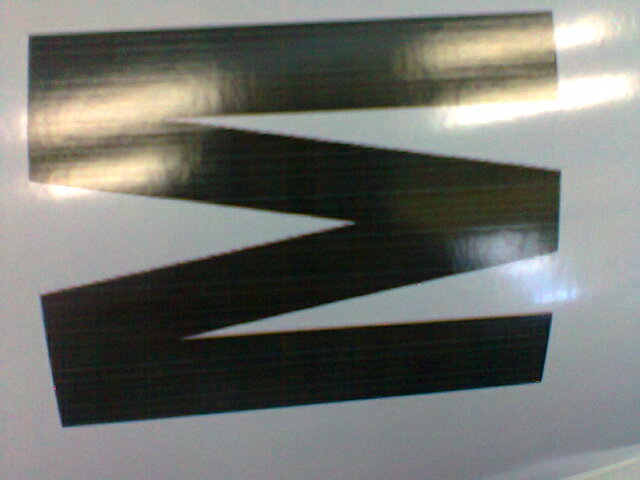

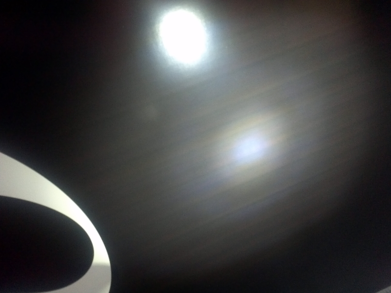

the nozzle check seems ok.cmy no problem,black only have two line missing.but the print quality is terriable.many white lines shows on the black color.

What kind of black you using? Looks like its too much black. Or low quality, try a higher quality profile.
ironchef
I had this problem couple weeks ago.... was laying on too much black. Try 10 40 40 100. Or 40 40 40 100.

Try using a uni-directional profile and see what you get. If it goes away, you likely have too many missing black nozzles. If it doesn't then I would guess you need to do a PF adjustment for that specific material.

Your black seems to have a lot of nozzles misfires,you cannot see it on the nozzle check on the normal mode, you check it on the diagnosis mode.
1. Before pressing the power on the up,down and right key,press it until the initializing is finished.
2. Use the left and right arrow key to navigate,look for adjustment menu.
3. Press enter then look for nozzle print.
You will see the full print of the cmyk,my solution to that is you need to ink charge your printer.but you have to be careful and extra cautious,too much inkcharge can break you printhead.
