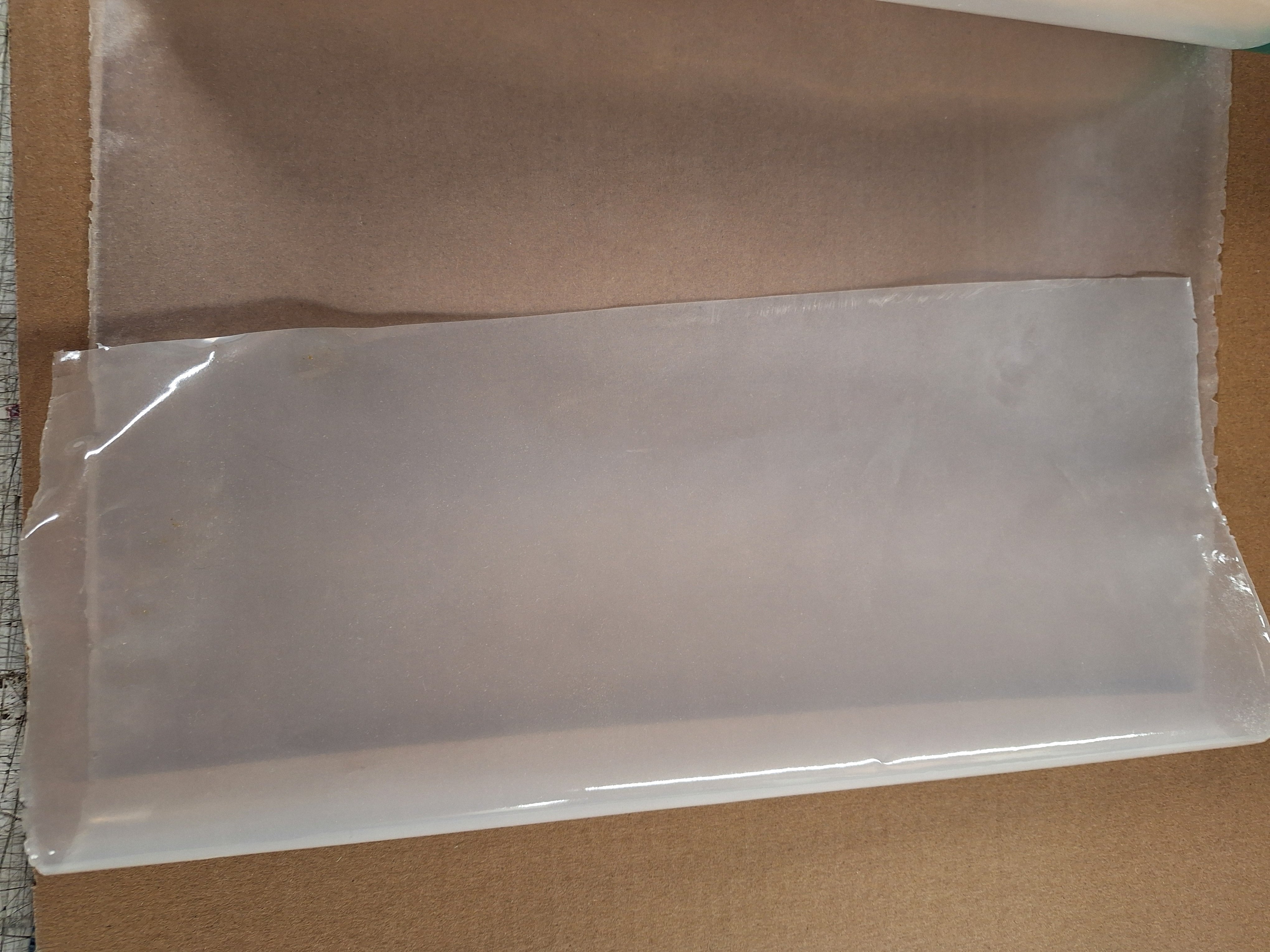

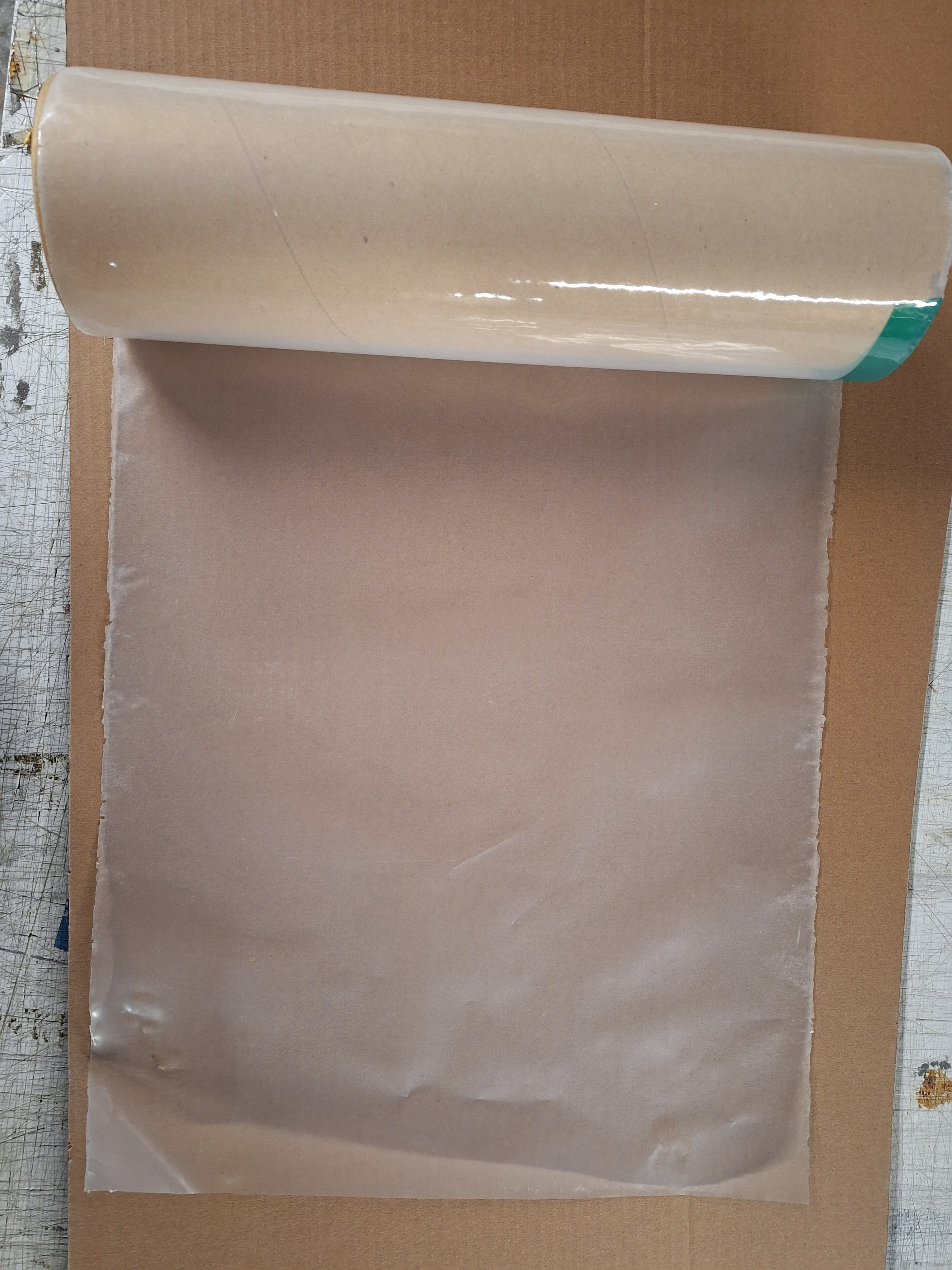

Hello all, trying to locate an item we purchased about 12 years ago from Graphitek of VT, who are long out of business.
It's a 15" wide roll of clear "release liner" (pictures attached). Shiny on the release side, matte (dull) on the back side. It's how they used to supply their masked cut vinyl. Many years ago we bought a 50 yd roll of the stuff from them, but I can't seem to find it anywhere now. Does anyone know where this may be sold? Or if it's as dead as Graphitek now is? ;)

Basically it's for cut, weeded vinyl. Instead of leaving masked vinyl on the existing paper backing the vinyl comes on, you would mask the vinyl, and then remove the paper backer (exposing the tacky vinyl side). Then, you'd place the masked vinyl onto this stuff (pictured above) to take the place of the "paper backing".
We were told by Graphitek they used it for "appearances and easier backer release". Apparently when they weeded their vinyl, they didn't want the "Cut lines" that are often used (to weed smaller sections at a time) to be seen from the backer paper. So they'd weed, mask, and transfer onto this clear liner. Seems a little frivolous, but the stuff did work well. It releases very easily, while surprisingly, still holding strong before needing to be removed.
