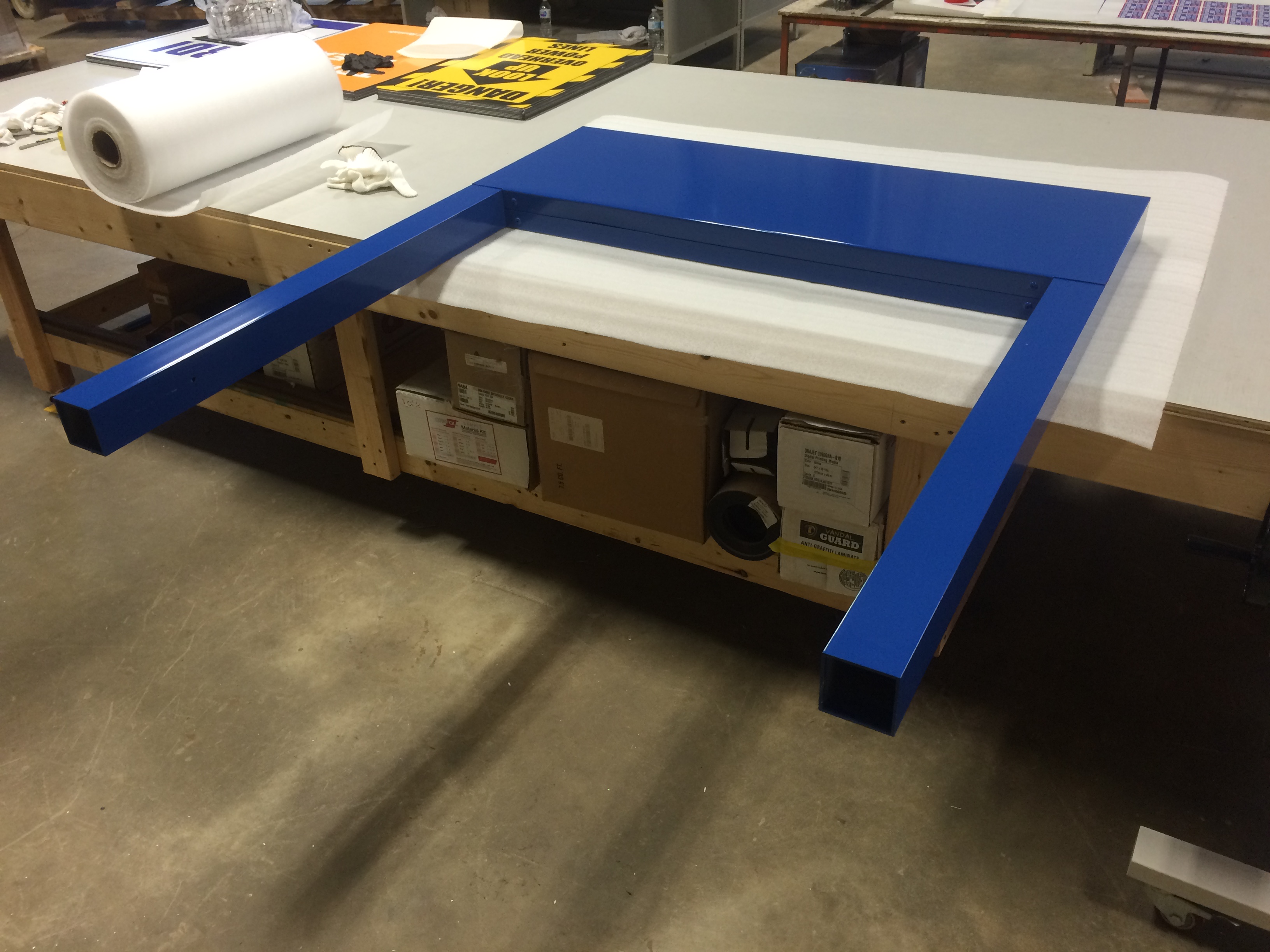

Put the top tube flush with the top of the posts, have them put a 1.5" 90 bend in the top and bottom of the face (063/080) and rivet it into the tube on the top and bottom where you wont see it. Put a blank face on the back end if its not double sided. Paint and letter.

If you go steel, I hope you're gonna powder coat them. Aluminum, you can, too, but don't really have to. Does that weight include the .080 aluminum faces ?? Or will you put the posts up and come back and set the faces in afterwards ?? If you do it all at once, you'd have to brace it so those winds you mentioned earlier don't move them. How will you attach a dead man post to steel or aluminum without having to go back and clean up a mess ??
