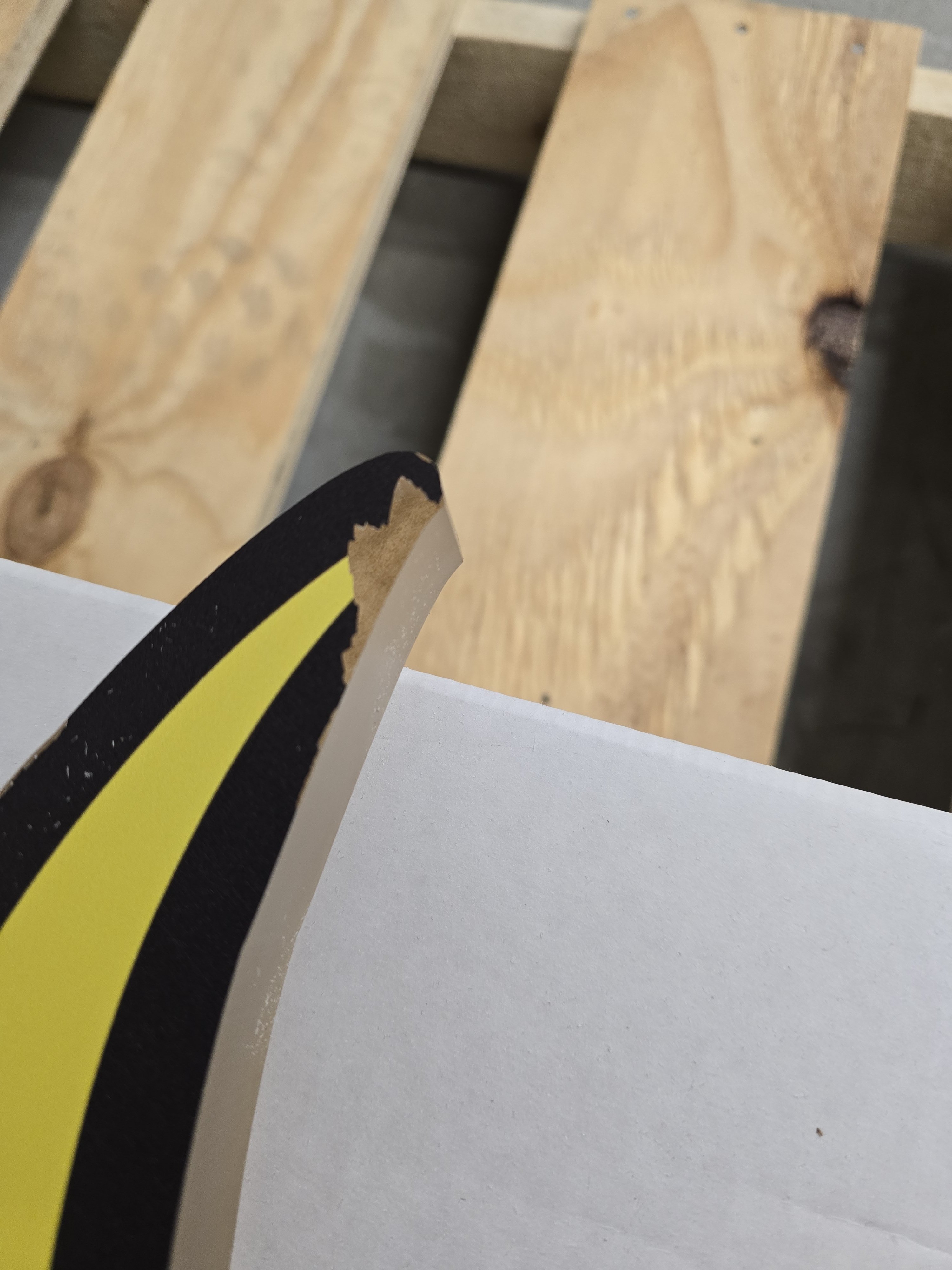

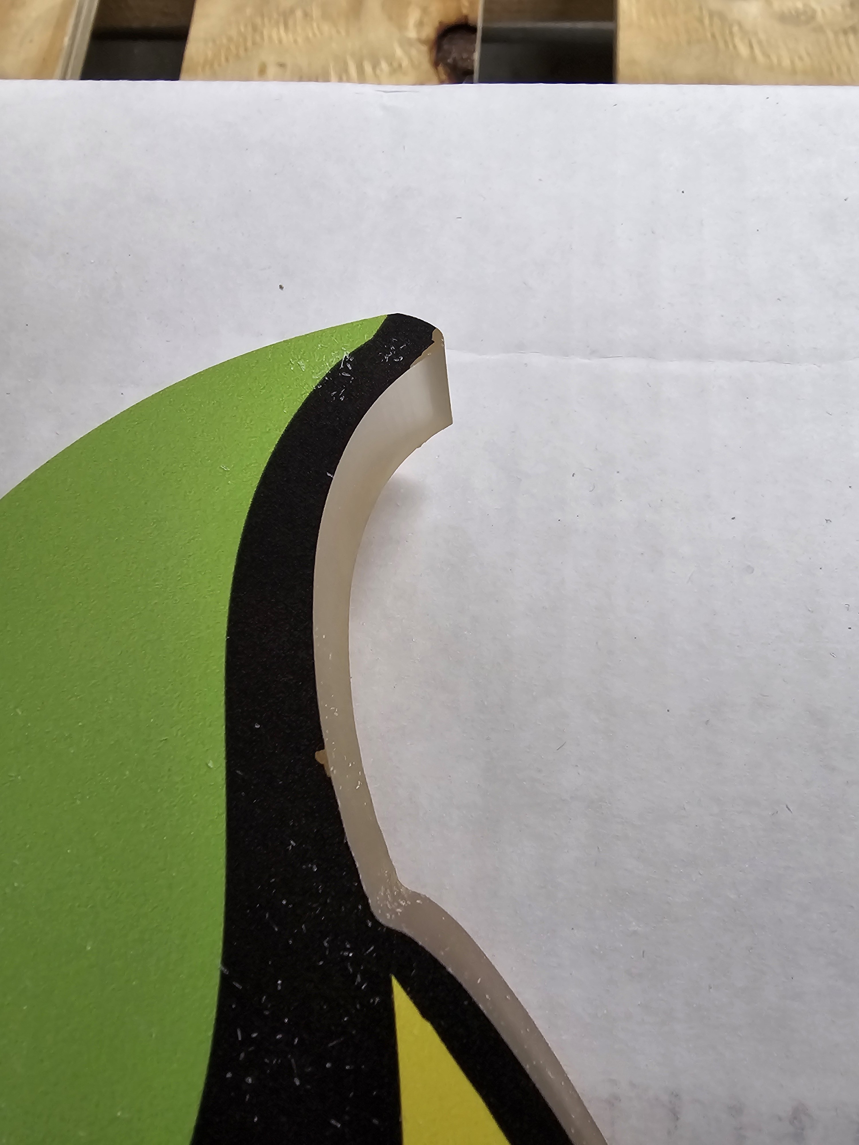

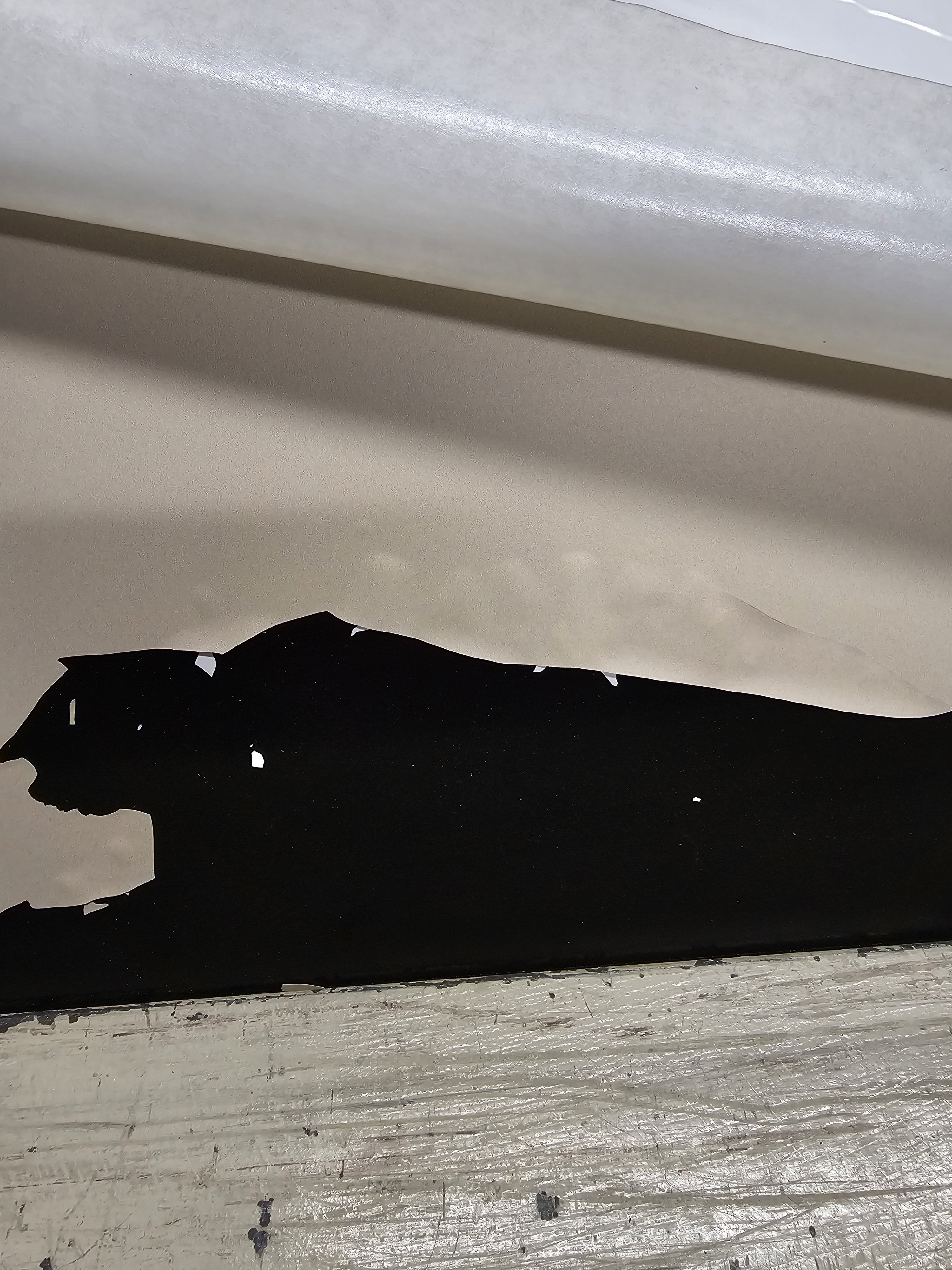

Here is some 1" Acrylic and 3mm Black ACM

Strange. Am I seeing this correctly? Is the white base coat just straight up flaking off? It looks like these pieces are separating from the substrate altogether and taking the print with them.
You said you were wiping everything down with alcohol; this might be a stupid question, but you give it time to dry before you print, right? You said that you have no problems with other colors, so I'd assume you were, but I have to ask.
I'd be curious to see if just plain white flakes off. Have you done that test? Maybe the white ink is bad? Wonder if it has or needs to be agitated (swirled not shaken). The issue seems to center around the white.
Hahaha. Yes it is dry when the printing starts. I actually just did that test friday and let it set over the weekend. I'll be checking in on it shortly.
