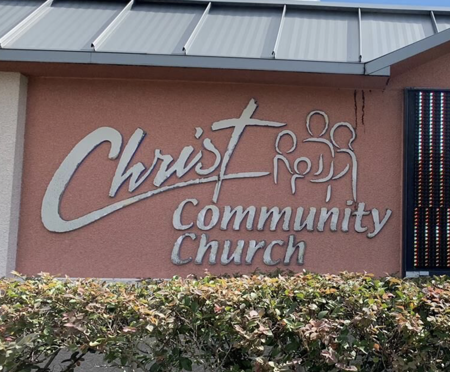

I had to refurbish a push-through for a church a couple years ago. It was clear with white on the facing of the letters and they edge-painted the stand-out letters blue. It was quite stunning when it was new. But about 6 years later when I got to it, the vinyl had shrank away from the edges leaving a nasty clear uneven band around most of them, patches missing, and the painted edges had chalked up. It looked bad driving by during the day, and REALLY BAD at night and had for some time before they finally decided to spend the money to repair it. After redoing that (repainting and automotive clear coating the edges, then translucent white vinyl on the faces) it lasted about 5 years until a logo change had me replacing the whole thing. This was in strong Florida sun, so you mileage might vary, but I'd definitely push them into the white if you can. Here's the before. Can't find the after pics right now.
