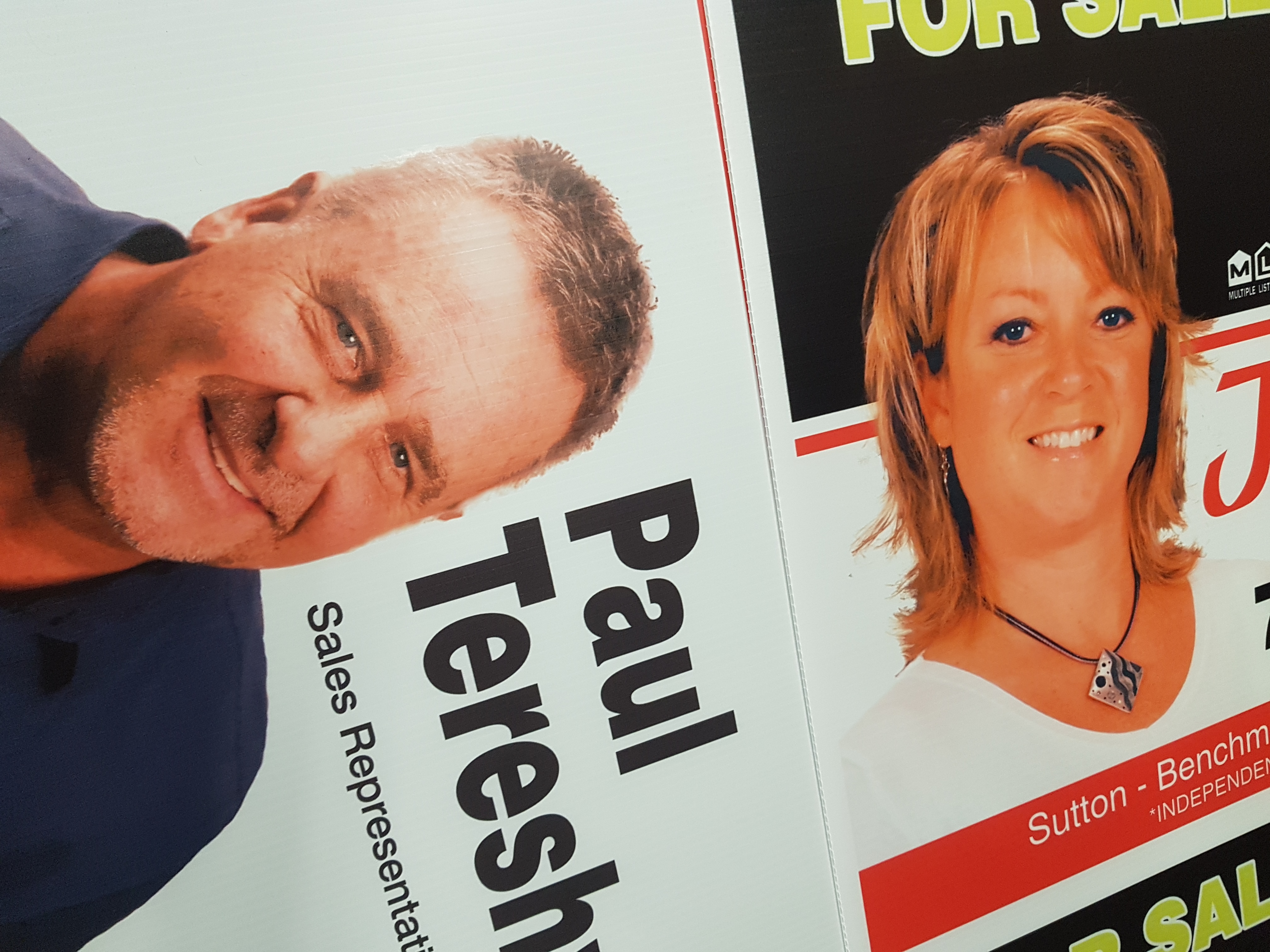

Why are all my prints starting to have a reddish look to the faces I print?
Printing on my HP FB750, inside signage Plus setting.
printing on 4mm white coroplast.
I adjust the color, hue and reddish issue in photoshop and it looks good in my file but when I print...it is reddish!

It might be time to linearize or reprofile your modes. HP is notorious, of late, for their UV inks to have color shifts and I have a feeling that is what's causing this. But, you may also want to check that your display profile and your output profiles are the same or similar, along with your intent. If those are not playing nice and your intent is not set up right it may cause your colors to shift inappropriately from expectations.

I just had a tech in who says my light cyan head is not firing so he changed the print mode to CMYK as oppose to CMYKcm.
It seems to have helped. Need to print m,ore to see. He also thinks I may have some bad inks. Even though they are still well within warranty time period.
He is checking with HP about inks and will let me know.
