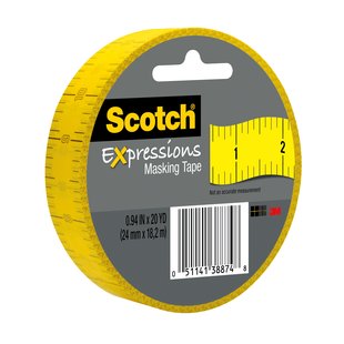

I recently discovered this masking tape at Target. It's not exact but it's so far been very very close (less than 1/16" error over 4 feet). $3 a roll and works great for something small you can keep with you in case of needing to take photos.
