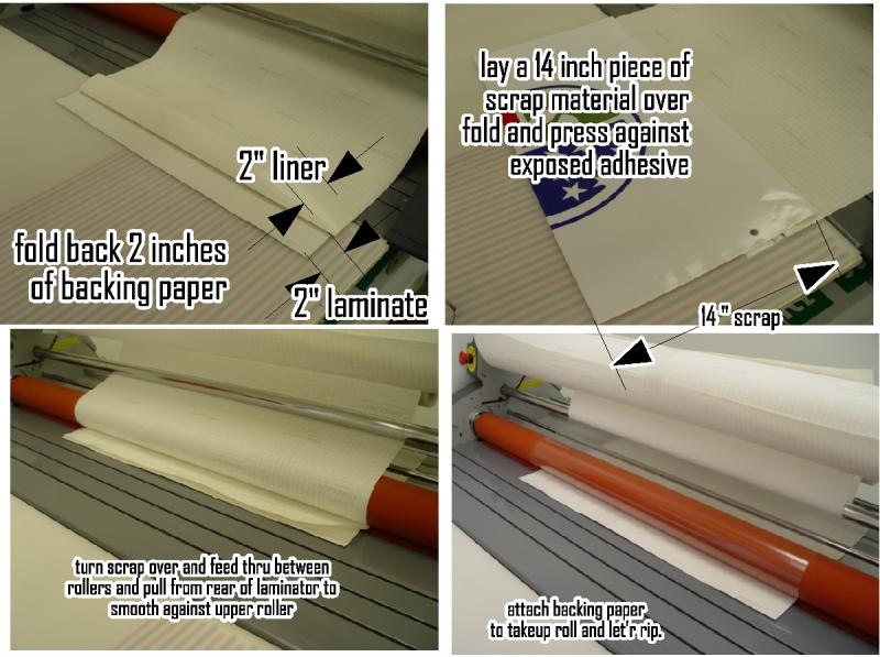

Gene@mpls
I have a 55" RS- no heat. Have never used kraft paper either- same size
vinyl/lam- I try to run 3-4- 8 foot sections at a time and almost never have
to cut sections apart to straighten.
Here is how i have always webbed rolls- see pict. This is the procedure to
web a new roll- once it is started, you just cut the backing paper and pull
the scrap piece out with the roll and you use that to reinsert the roll the
next time. It works a treat. I did not spend too much time putting this
visual together- hope you can figure it out. Gene
