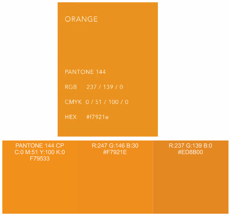

Why the color variations?
myront
Dammit, make it faster!!
The top rectangle is the specs from the client but pantone doesn't match the hex, use the hex and the rgb values don't match...

I always tell customers matching pantone colours isn't normally possible for printing as they are different systems and a CMYK printer cannot exactly replicate most pantones, so there will always be some colour variation. If it essential I will print out some test squares and send them to them to choose the one they like the best. Also of course a lot of customers think a colour on a PC screen will look the same as the printed output with no understanding of how brightness and contrast controls etc... change them

In this case I would print some samples and match the orange to my Color Bridge. Usually all the colors won't match on the screen.

The top color is spec'd as "Pantone 144", no mention of WHICH Pantone book though, and the 2nd color is marked as Pantone 144CP; both are different books with different values.
Always watch out for those tricky designers using incorrect books screwing up customers' prints!

Uh...they just sent a new version of their logo and you'll never guess! Color values are more off than before. Now their eps file reads Pantone 144 C, C11 M55 Y100 K1, Hex #DE8703. I told 'em we'll use the cmyk values and you get what you get. lol
Also sent them a snip from their own guidelines pdf. Corporate has to approve the design but the client is "designing" thru me. She wanted to do it herself in Canva but...

The only meaningful specifications of a color are either a L*a*b* number or a spectral reflectance distribution.
You get these by actually measuring the color, or by having access to Pantone's L*a*b* specifications for
their various swatches. If someone provides you with an image file as their specification, get the L*a*b* number
from the image file.
You may want to read: https://www.projectbbcg.guide , which provides some useful information
about how color measurement using a spectrophotometer is important. That ultimately means
buying something like an Xrite i1pro2(as long as xrite continues to provide repair/calibration services
for it) or i1pro3.

Print a Pantone color chart and hang it on the wall. That's what you can print, pick something close. If what you want lies between two colors on the chart, choose the darker of the two. Never forget that what comes out of the printer is the truth, absolutely nothing else is.

This or if you're using Flexi, use the color mapping tool. You pick the pantone you want to match, it prints out a chart of a range of colors around that pantone, you pick which one that looks like it the most, and then from that point on Flexi maps that color to that pantone. Pretty useful in these situations.
