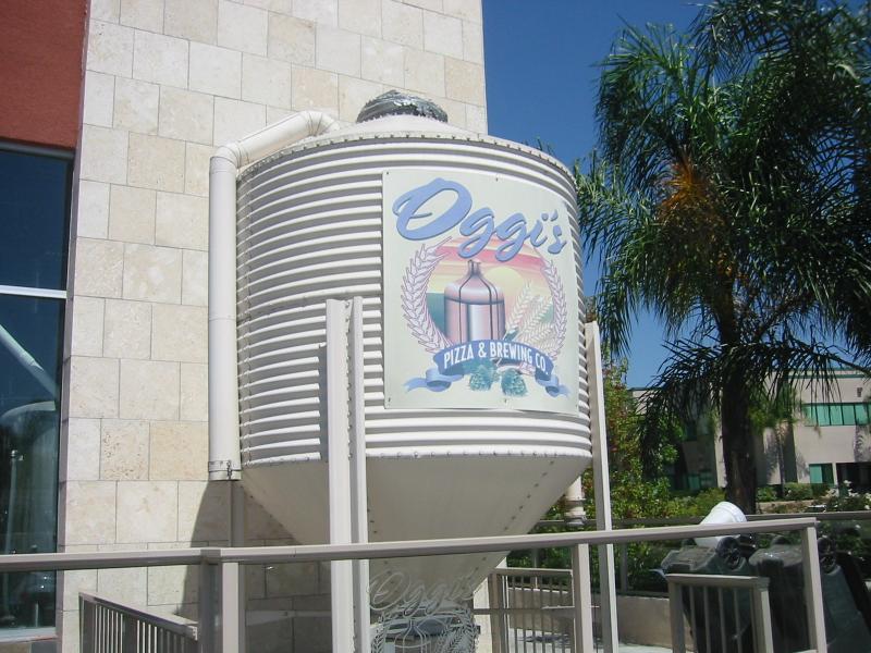

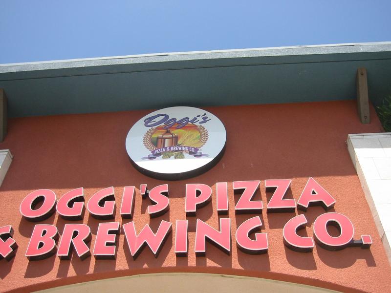

Here is a sign I did 6-7 years ago. Both face the same direction, south so they get the sun from sun rise to set. The Channel Logo is Gerber Edge non lam, while the Fermentor print is solvent ink.
