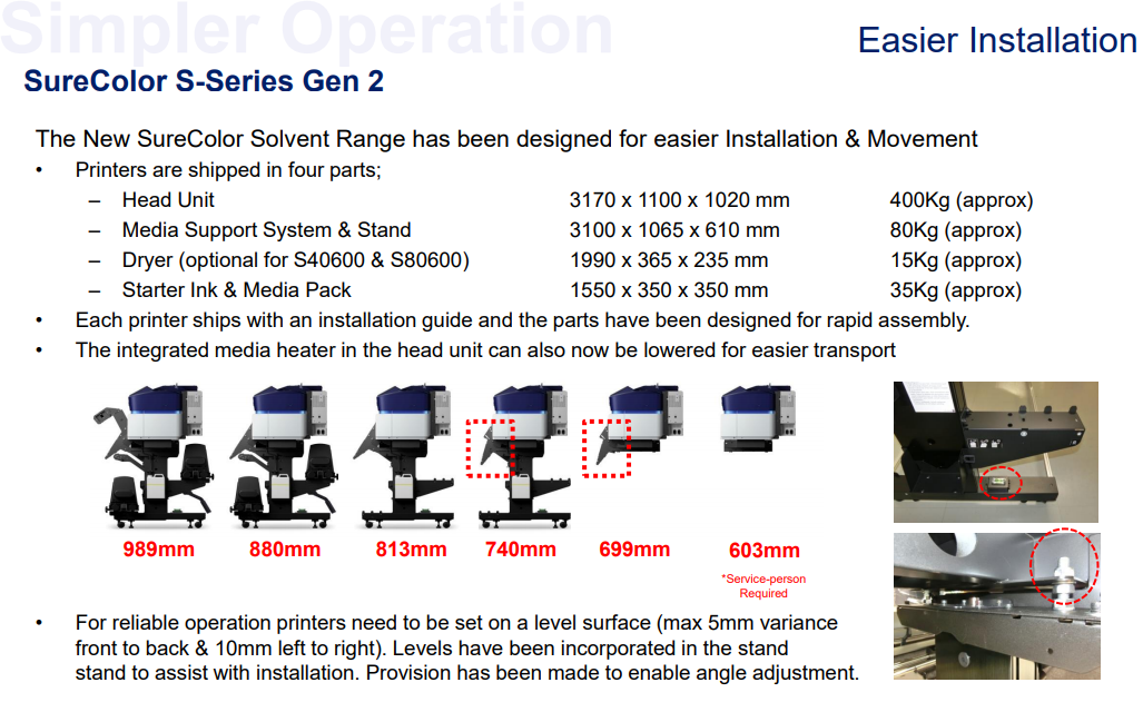

I'm in a temporary location and looking to order an S80600. Will it fit through a standard interior door? I think the width of the door is 32 inches.
The dimensions I find online are 103" W x 34" D x 53" H
I'm assuming the widest part includes the front heater. Is that removable? Or is it the 34" deep because of the take up reel and media feed unit? If its because of the take up and media feed unit, i think those can be assembled after it goes through the door opening?
Does anyone have the dimensions of the machine on the stand without the media feed unit and take up reel installed?

34" is pretty accurate... I just measured ours and that measurement is from the front edge of the heater unit to the rear-most part of the media feed section which sits in-line vertically with the bottom of the printer stand anyway, so removing it wouldn't gain you a lot of leverage.
You could possibly get the printer through a 32" door if you removed the big poles on the rear feed and wheeled the printer in on an angle a little bit.

Hmm. So the take up feed is in line with the back of the printer unit itself? Rolling it in angled may work but since this is a temp location, I don't know how well that would work when we need to move it out and it's filled with ink. We have a Mimaki UCJV in the location now that we will be moving out but it's only ~27" wide so that was no issue

Do you know if the front heater unit is removable? I think it would be possible to roll it in at an angle if the heater unit comes off and without the media feed and take up unit installed
BVG
We fit ours through a door that was 31" with no trouble. IIRC there's a section in the manual about how to prep the printer for narrow doors.
The heater unit on the front can be loosened and swung down to give clearance. Combining that with removing the front and rear media holders meant it was pretty easy.

This is the info I think I needed. I tried looking in the manuals I found online but didn't see anything about moving through narrow doors. Maybe I'm just looking at the wrong document. I'll keep looking for it though. This helps a ton!
The S80 goes through a normal door. The S70 didn't as the heater stuck out farther. I know that from experience. haha.

I had to take off the take-up real and a couple brackets on the heater unit on ours to fit.

I ended up taking the heater off to get it through the door, as I didn't want to take it back off of the stand. When it was off of the stand, I was able to tilt it to get it to fit.

Mine fit through a 35" door without taking anything off (although you should take off the take-up reel knobs regardless, so you don't bend/break them.)
Looks like it would just barely fit through a 32" inch door if you took off the entire rear take-up reel and support arms. If you could loosen the heater just a tad, then for sure, but I've not had to do that.

or get a handyman to remove some of the door trim. you could gain 2 inches, and leave your epson "virgin" (with perhaps a scuff on the sides, at worst)
