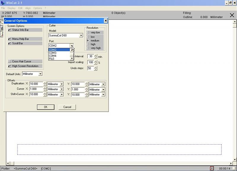

i wish to cut from wincut 2.1, but, unfortunately my summacut d60
doesn´t have USB plug.
it´s connected via parallel cable to pc, but couldn´t work properly .
the program setting contains just com1,2,3,4 and file, but not LPT .
i have another cutting softwares, byt this is my favorite one .
could you help me please?

as i mentioned before, wincut 2.1 doen´t offer set up to LPT 1,
just com1,2 etc.
it´s strange, because winplot does.
any idea???

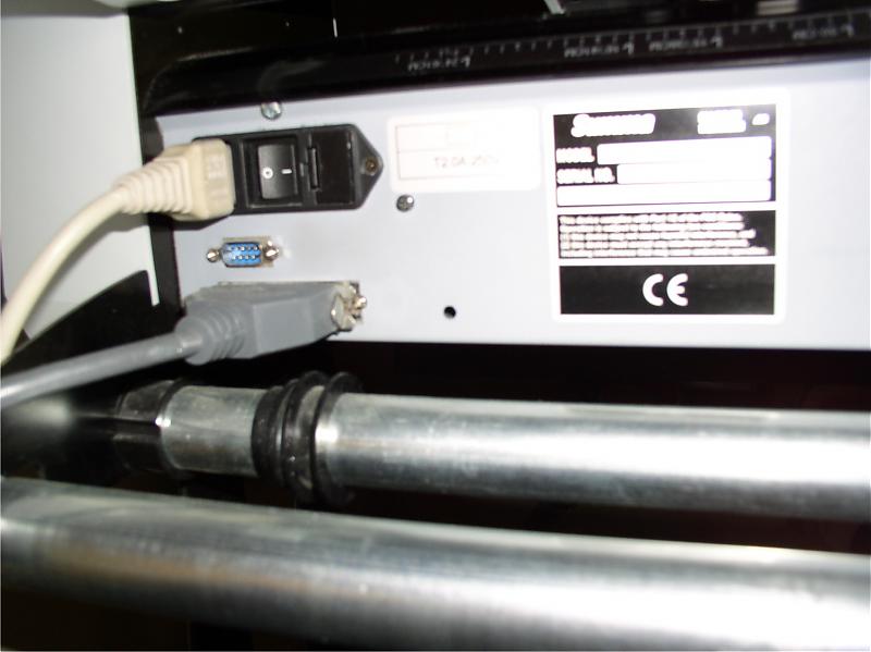

Are you positive that your D60 doesn't have a USB port?
It would be directly under the power chord socket. It's not the slim rectangular slot called a USB type A, but it is more a square shape.
It's called a USB type B plug. Sorry if you already know this.

If I remember correctly, the Summa D60's did not include a Parallel Port connection... Only Serial or Serial/USB with the D60u models.
If my memory is correct, why do you need an option for the LPT port (Parallel/Printer)

i´m sure, my d60 doesn´t have usb switch/please check it by yourself :)
the male switch cable from plotter is parallel, and the male switch to my pc is serial.
the main problem is, that when i like connect plotter with summa cutting control, i can´t finish it, the is no option for non usb connection.
plotter is connected to LPT1, but how can i set it up, there is no free ltp1 port in general option.
winplot is fine for cutting, but i prefer wincut, i use it at work.
what do you think?any ideas?
