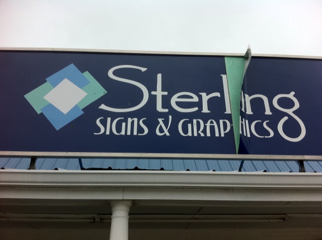

The aluminum peeled away from the plastic on my alumacorr sign during some heavy winds last night. Defective product or did I just do something wrong?
In case it's not obvious, there is a seam where it's pulling off because I had to use a 4' section and an 8' section.

phototec
Wow, that doesn't look good!
Because you are in the sign business, you might want to fix that right away, so customers don't get the wrong idea about your quality.

Wow! That's some serious wind. If the sign stayed up there despite the wind I'd say you had mounted it correctly.

WrapperX
Sounds like it should be under that time period to at least call them and ask the manufacturer about it. I would think that if YOU did something wrong then the whole sign would've pulled up. But only part of it - their part of it - came up.
I'd call them.

Hold on there cowboy.
How did you finish off the edges before or after you applied the print ??
Did you seal them with anything ??
  1. They should have the voids completely filled and sanded flat.
  2. Primed.
  3. At least two top coats of paint.
  • Now proceed to installing your graphics.
If all you did was run a roller of paint down the side, I would imagine your warranty is void. If you did nothing to the edges.... you're definitely S.O.L.

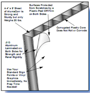

Alumacor image below.
If it's the NUDO brand I had the same problem with a couple of sheets I bought first of the year. You could see the "bubble" in the aluminum where it had delaminated from the plastic. Fortunately I hadn't lettered it and my supplier took it back with no questions. When you go to remake the sign ask your supplier to get you a 12' sheet of alumacor and avoid the seam altogether.
