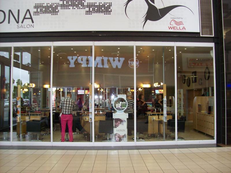

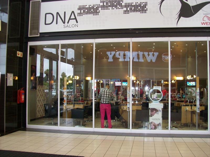

Good day,
Hope some people might be able to assist. I am going to be frosting a storefront window (51 inches wide by 124 inches high) please excuse my use of inches I’m South African and we use the metric system, anyway I would like to use a wet method on a Hexis S5DP Etched Glass Series vinyl as recommended. A little more information about our climate: Hot most of the year, the temperature is from 68F to 95F and were I’m based there’s very little to no moisture.
Here are my concerns:
· The application will be for a hair salon, would this affect the vinyl in any way? - Heat, moisture etc.
· I will be applying the frosting via wet method and the area to be frosted is quiet large so should I use a larger squeegee?
· Currently I use a basic solution sprayer, I feel this job requires a pressurised pump sprayer what are your suggestions?
· This is the first time I am applying to such a large area so any extra tip or tricks would be much appreciated.

I'm not familiar with that brand, but if it's anything like similar Avery, 3M or Arlon vinyls, you should be just fine as they work fine in interior uses (unless I'm mistaken, that looks like a mall-type setting, so you won't get much as UV degradation). I'm sure over time the hairspray/product/whatever they call it would have some effect, but not that much. Maybe borrow a bottle of whatever they use and test it if you're nervous about it.
As far as the application, I always use regular spray bottles, but that comes from not having enough uses for the larger sprayers to justify the cost. I think you'll be fine with either. And yes- a larger soft squeegee would be a good idea. I'd say just make sure you've got a good "coat" of application fluid (and a lot of rags/paper towels for cleaning it up) and have at it.
I would also add that I'd do everything in my power to convince the customer that this needs to be done either before or after their business hours and they've cleaned up all the clippings from any workspace you'll need. All takes is one and the whole thing is ruined.

Yep, you'll be fine. I agree with Southpaw to make sure the salon has every hair cleaned up from the area. When you start, you'll likely create some static peeling the vinyl that will attract every loose fiber. Soak the windows and soak the vinyl as you peel it from the liner and have at it. A large felt squeegee will be your friend here. Try to stay away from the harder plastic ones as they can mark frosted vinyls.
