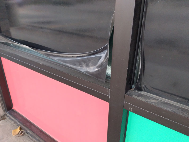

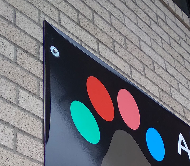

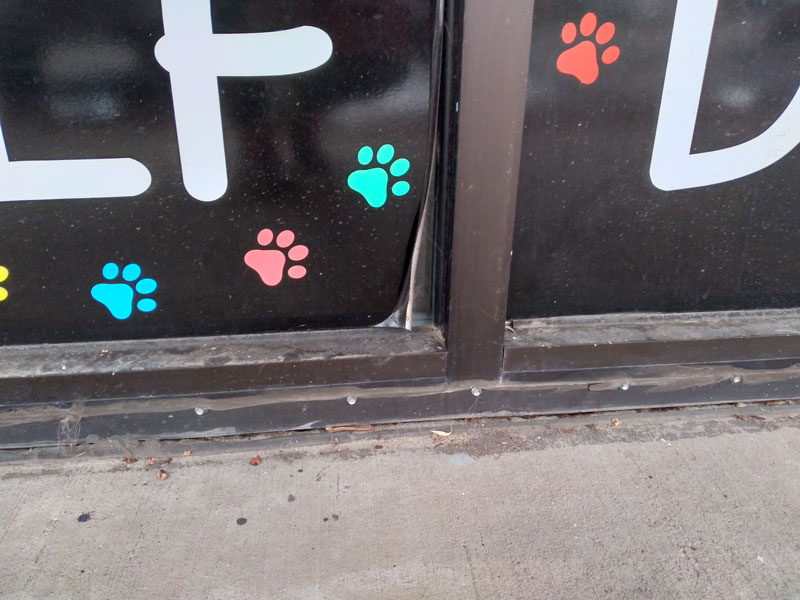

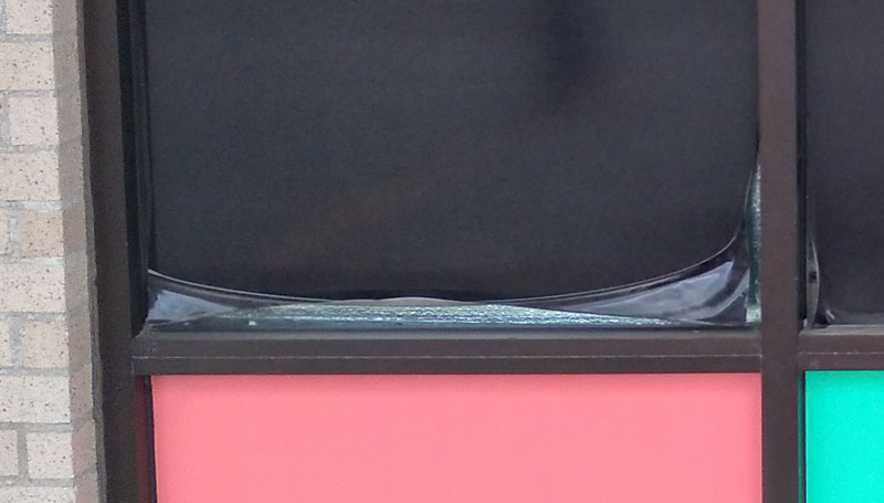

I checked out the peeling vinyl yesterday. It's all 3M IJ35C laminated and was installed by another shop in 2019. Nearly every window is starting to peel in the corners, mostly at the bottoms, and one in particular is all peeled up along the bottom and warped by the elements. Even the sign up on the building is starting to peel along the top edge. This seems like a material defect and not an installation mishap - what do you think? The windows face east.

That is a five year calendared intermediate vinyl. Full sun plus lots of black printing equals high temperature which challenges both the vinyl and the adhesive. Calendared films are created using beads of plastic - the elastic memory of the material is such that it wants return to is original shape, thus as it ages it can curl. This application should have used a premium cast vinyl.

Agreed that Cast is best for this
if the budget doesn't allow for Cast, at the VERY LEAST
1. do a white border, NO FULL BLEEDS with Calendar
2. Use a CAST LAM on the calendar print
the sign could have been done CAL on CAL, but you MUST edge wrap the material.
NOTE: that sign install could really look better, seeing the anchor bolts and fender washer looks cheap.
next time print some "patches" to cover the installation hardware or take a rattle can of paint and paint the hardware BEFORE install

We said the same thing when we saw the bolts, it looks terrible. This is what happens when customers install their own signs.

Somewhere on the forum someone posted that they had wrapped windows in black vinyl and one or more of them cracked/shattered from getting too hot. I know that's not what's happening here, but if this ends up being a redo should I suggest to the customer to not go with solid black again, in addition to using a cast vinyl?

I have had that problem once, when tried to save money on the laminate! Use only optical clear cast laminate and you won’t have that problem… We trim down the vinyl the with of out blue Avery squeezee btw nothing more! We always use the orajet 3676 and oraguard 297gf laminate. Even have shop Windows with +4 years now and still looks good

This finally became a job. I originally quoted it on cast vinyl after the discussion we had in this thread, but the customer is open to perforated which I would prefer because it's easier to install. Going to apply clear edge seal tape around all edges. Was wondering if anyone ever uses strips of cast vinyl as edge seal? For the panels that are black, using black edge seal might look nicer.

Looking over your pictures, it looks more like a prep failure. The installers didn't clean the area well enough and basically applied to dirt. As water built up on the lower ledge + calendared vinyl returning to shape = failure. For the building sign..no clue other than didn't prep the aluminum well enough?
