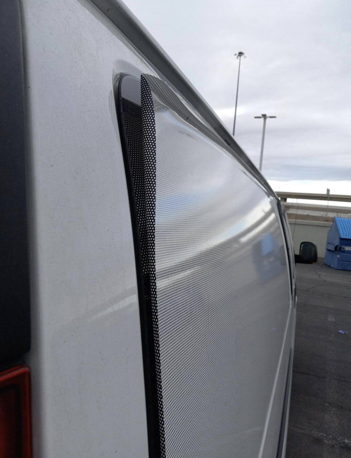

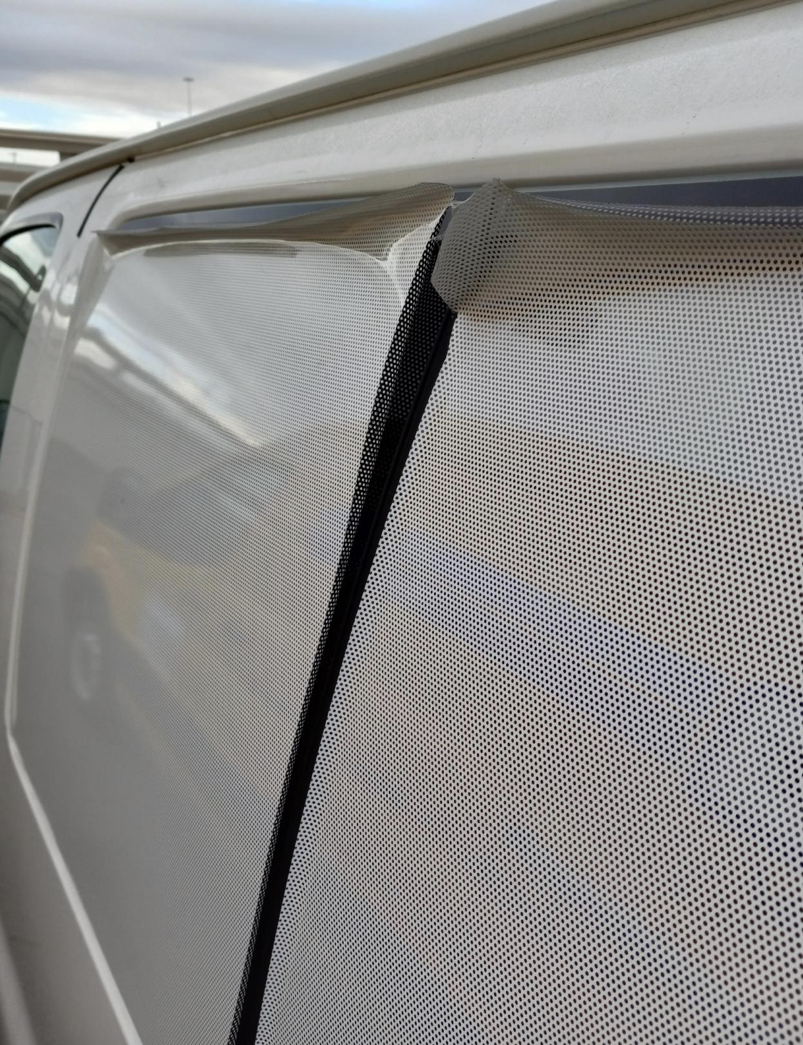

Sort a weird issue, we Laminated some Window Perf for Windows on a Van and 2 days after Installation noticed all the Windows that had Perf were rolling themselves back off! We did a second can and no issues, same material, same Installer. After talking to my guys we discovered that the Van that is failing was Laminated at about 119* when they should and typically run them around 80*. The second Van that is not failing was Laminated at 80*. Here is my question, typically in the past when a Graphic is trying to roll itself off it has been too much tension during Lamination, could our issue be simply caused from the difference in Laminating Temperature? Perf was Laminated to hopefully last longer in Las Vegas.

We are re-doing a van right now with this exact issue. We are putting new graphics on, cutting back the perf about 1/4” and using seal tape all around. I am convinced that if you don’t use seal tape on window perf, you are risking failure.

What perf/lam are you using? This can definitely be caused by having too much tension on the laminator.
The tack is so low on perf that it doesn't take much for it to fail along the edges like that.

We are seeing this more often with newer glass or glass that has been treated, rain-x or a like coating
We edge wrap with optically clear lamination strips, or we use an edge seal pen

Do you mean you wrap the perf around the edge too? Or perf up to the edge and then wrap lam around the edge?
I could definitely see the temperature difference causing this. The higher temp allowed the laminator to stretch it as it was applied, after installation it wanted to shrink back to what it was and peeled the edges up.

the silicone in hydrophobic coatings such as Rain-X or newer "clear coat" washes (from the car wash or even the newer 'ceramic' sprays) will negatively impact adhesion. Make sure these are either not used, or are removed before applying any adhesive.

I agree the silicone coatings can be very difficult to remove. I am pretty sure acetone would work to remove Rain-X from glass, but do not get it on the paint!

If I don't trim the perf back at least 1/8" and use optically clear strips on the perimeter, I found that the material would lift after a few weeks, and if on tinted vinyl, fail in only a few days due to the heat from the darker tint that's reflecting. In most cases, I'll suggest NOT to use window perf due to the various problems that can occur.

I always used to use 3M 94 Primer around the outside edges or along the overlapping seam. We use that religiously on all window perf installs.
