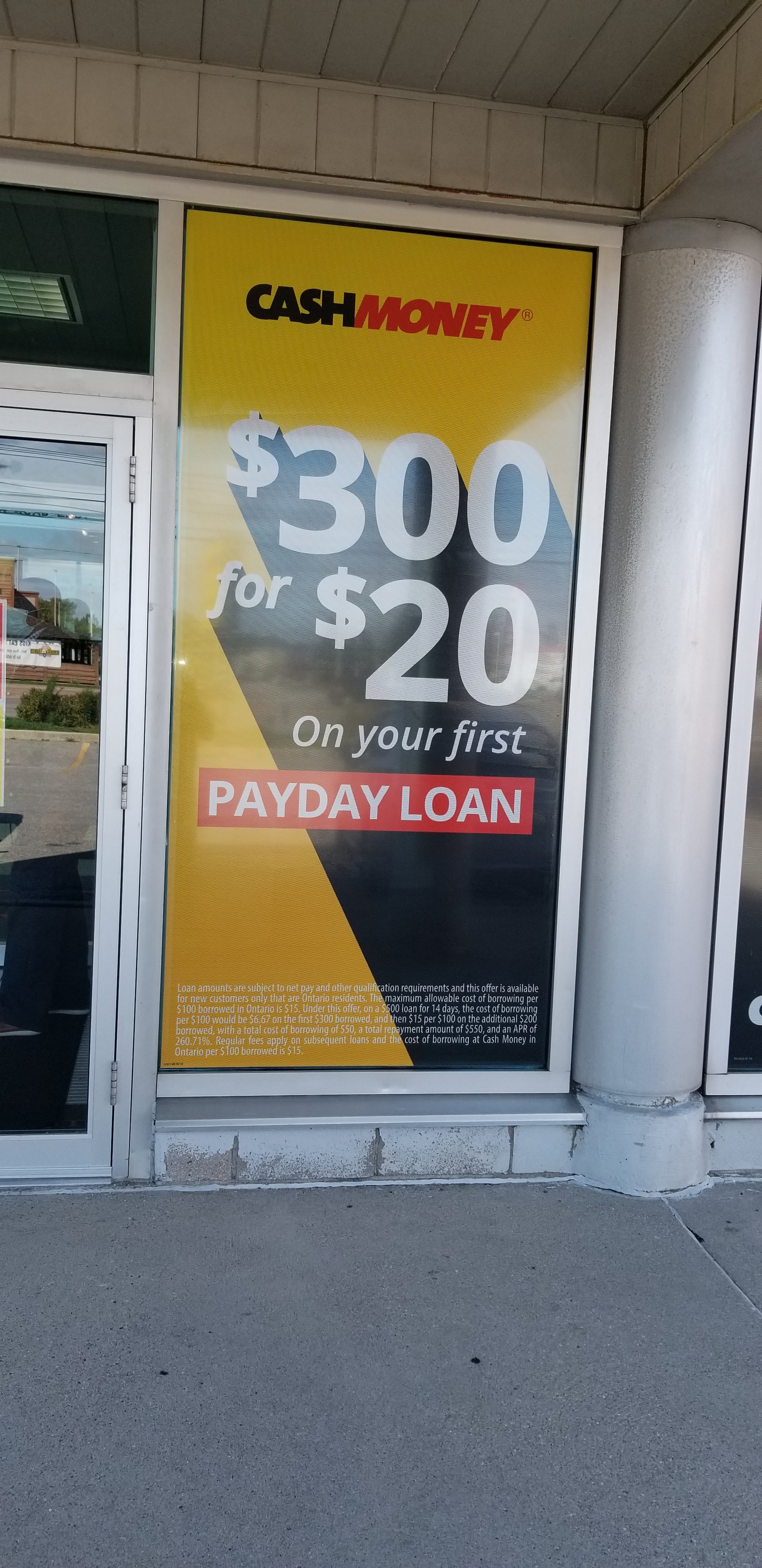

Did you done edge sealing right?
With .5 in clear tape?
I always do with .5 in with optically clear laminate for it.
