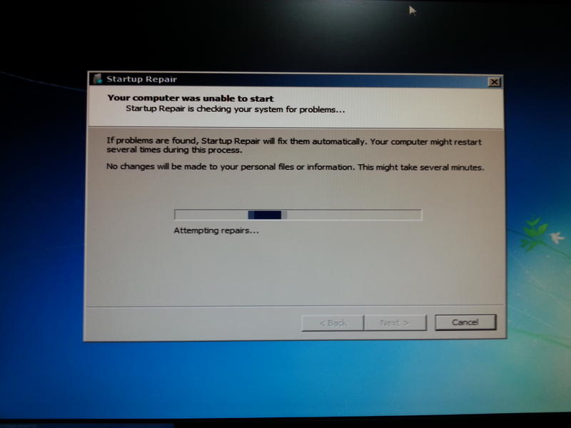

Well the Startup Repair application is running (2 hours now-see photo), I just don't know how long this is suppose to take?
I don't even know if it is actually doing anything, it could be hung up?

After seeing that picture, I would agree, should of only taken a few minutes, not hours.

Should only take a few minutes.
Sounds like a bad sector.
mark-s
I could take upwards of 30/40 minutes depending what is on that HD, but 2 hrs is much too long.
I would imagine that the OP has done a hard reset by now. I would unplug the cable and let it try to get out whatever excess juice it has in it (press start button with power still unplugged) and then try to restart again in safe mode and try to look in the event viewer.
It could be a lot of things, problems with starting up, virus, bad sector, bad update etc.

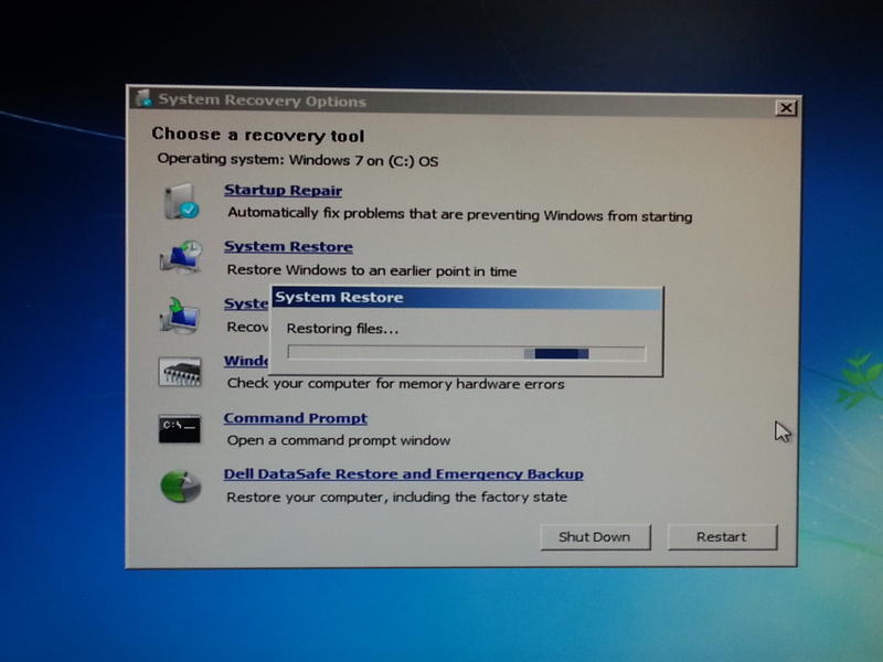

I tried using my Windows 7 Repair Disk made in November that didn't work as noted above. Then I tried to use the onboard recovery tools by pressing F8 several time will the computer was turning on, this time I was able to get to the screen where you can select a previous Restore point and I selected one from Jan 6, and it started to Restore Files (see screen shot), it has been doing this for 9 hours now and still say Restoring Files, however it doesn't seam to be doing anything, the hard drive light is solid and NOT flashing.
The computer with the problem is a Dell XPS 8300 (Windows 7), I would like to remove the hard drive and put it into another older machine running Vista, to recover all the application files like Versaworks and files that where in the MY PHOTOS folder.
You said you pulled the hard drive out and slaved it into a second pc and were able to find and replace the file that was stopping the boot-up. What do you mean SLAVED IT, what do I need to do to be able to have the other PC see the files on the HHD?
How did you find and replace the file that was stopping the boot-up, what software did you use to do this?
Thanks

You can do the same thing as thing by creating a boot disk or System Disk, Putting the disk in your disk drive and then restarting your computer. as long as your system is setup to boot on your disk drive first Hard drive second it will use the operating system files on the boot disk to start up your computer then you can look at your hard drive.
Before you go taking out your hard drive I would first try the the Dell sight.
Its Free has good info on what to do, you can even talk with them for free.
There is also a way to start up your computer and have it load one file at a time and will prompt you after each file loads, this way you can see which one is causing the problem. If this is where your problem is?
Your problem could also be in something that is attached to your computer. unplug everything that is not necessary. then restart. Just your keyboard and monitor hooked up.
How many beeps are you hearing when you restart your computer, The absence of those beeps or more than one beep at startup tell ALOT. You should here only one beep at start up. That one beep is self diagnostics for the power up and one beep is saying that your power supply, mother board and all peripherals attached have passed the power up diagnostics, after that beep it starts to load your operating system. There isn't much use getting into anything if your not getting that first beep.
Nat
