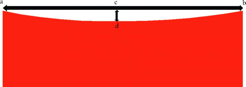

Place measuring tape from a to b. Next measure distance with ruler from c to d, this is your arc. Bend text to match arc in cutting software.
