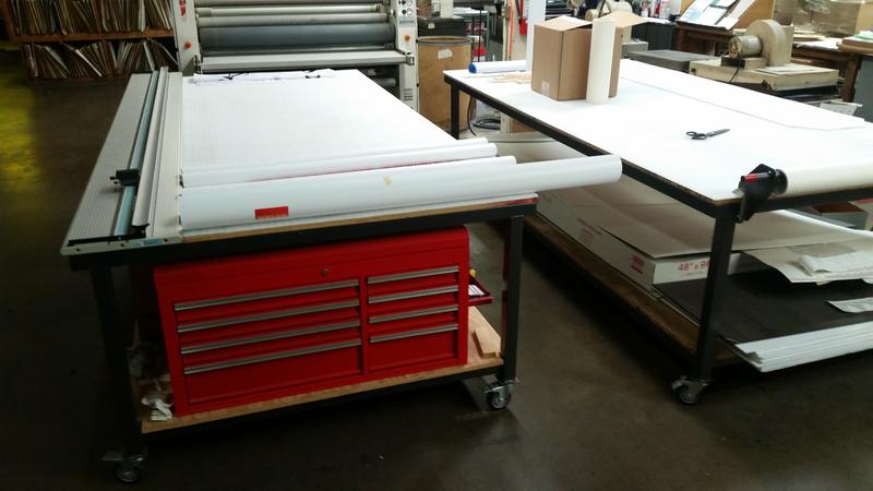

We built our own steel leg tables with 3/4" tops and just added the Rhino cutting mats.
attachment.php
