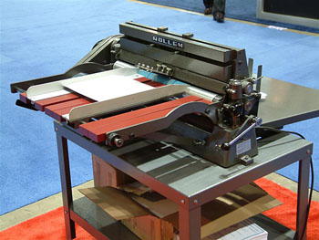

What is needed is a machine called a semi-slitter and media with a removable adhesive.
