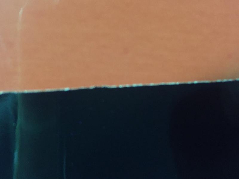

Hey all,
I'm trying to switch to wrapcut along with the other 9 installers here but I can't get a smooth edge with it. This is especially irritating when used on a printed film as the white edge looks particularly jagged. I'm pulling it tight as I lay it, squeegeeing it down, squeegeeing the vinyl down over it and have even tried post heating the two together. Anyone able to shoot a quick tutorial on a nice clean cut with wrapcut (the demo videos don't really show a close up of the edges.

ChaseO
I would love to see a quick tutorial on this stuff! I have used it a few times, sometimes with great luck, other times with no luck, and I can't figure out what I'm doing wrong. :banghead:
TDFcustomSL
I am out on the tutorial BUT, the few times I have used it it has worked well for me....IF I remember to leave myself enough extra tape that I can get the string wrapped around my finger a few times to give it that quick initial yank to get it to start the cut. After that I have found that pulling it as quickly as possible helps with a clean edge.

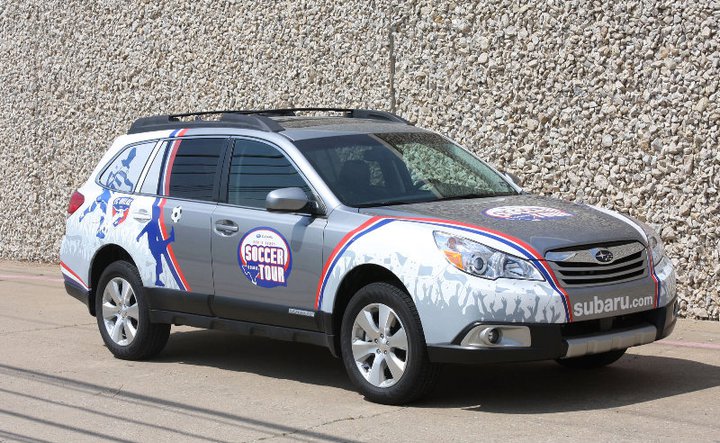

mnapuran
We were the first in the country (USA) to get a roll of the tape from the manufacturer before it was released as a product. Helped us finish a job that would have been almost impossible without it. Only had the rough issue a few times (use it often) and it's typically due to the pressure and angle of the pull and making sure the material is down good around the tape.
I believe one of the pictures we took is still on their site to this day :cool: Job we used it for initially...

joelswork
Best way I've found to use it, so far, is to apply it as instructed...then use it as a guide for your knife to actually make the cut :(
joelswork
The concept is a good one, but the fillament doesn't make a clean cut...it's too sticky and the micro notches seem to match the cord winding....

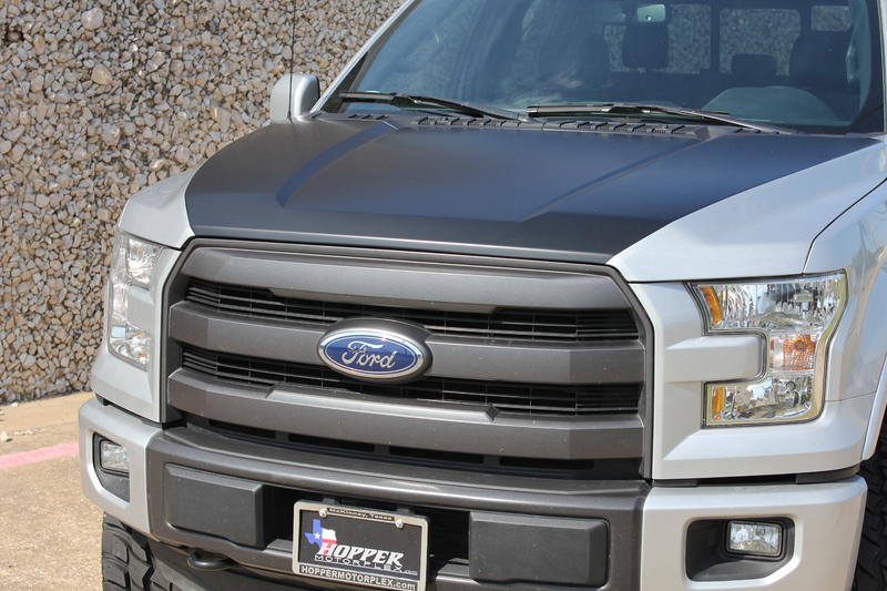

Used WrapCut again earlier this week :cool:
