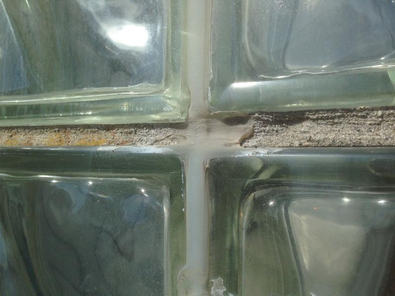

Ok guys, I got some pictures of the job. I appreciate your input. I've attached a picture of the walls and the block/grout detail up close. They would like the wrap to span over the tiles as much as possible. Obviously the tiles will show to some degree.
My thought is that it would be easiest and most manageable to do 48" x 96" swaths, horizontally, bottom to top. There would be 2 of these swaths going up per wall with a couple inch overlay.
If I go with the textured wall wrap, does it have good repositionability if I mess something up?
And again, the customer is wanting it to last at least 3 years if possible.

That silicon sealer in spots on top of the grout/cement is going to be an issue.
Even if you work it down in there with heat it is going to lift back out - sooner than later.
Let the customer know and if he is aware and still wants to do it - drive on.
