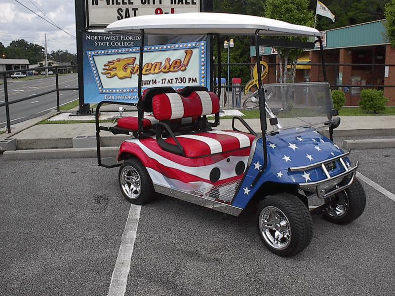

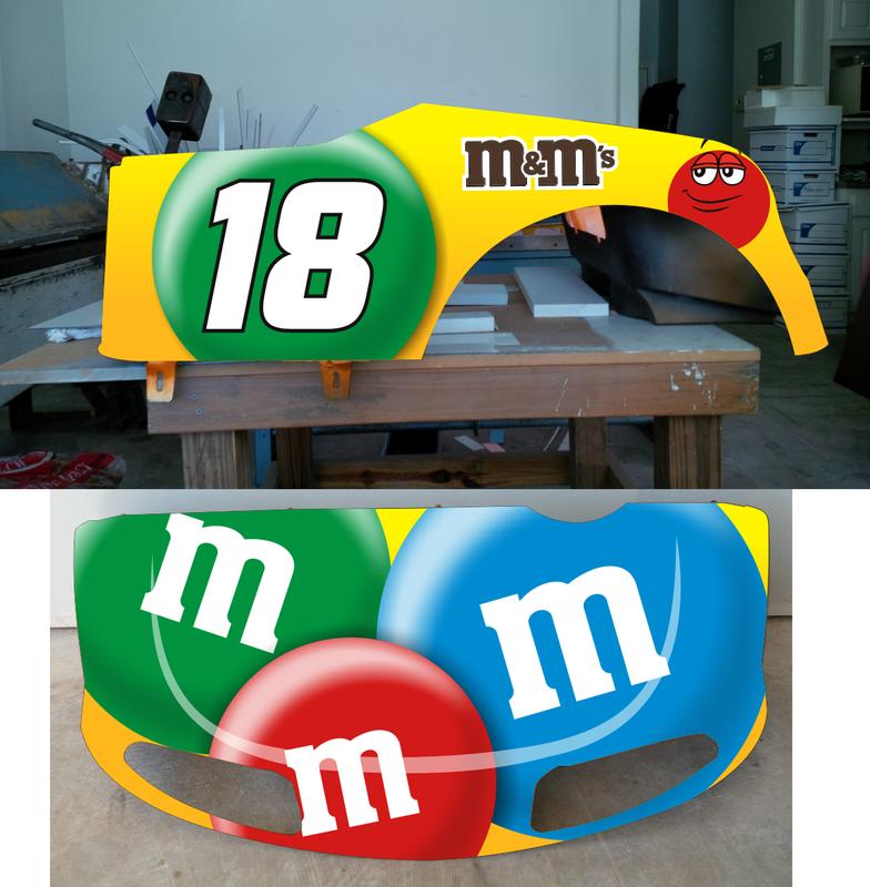

IJ180 worked good for these

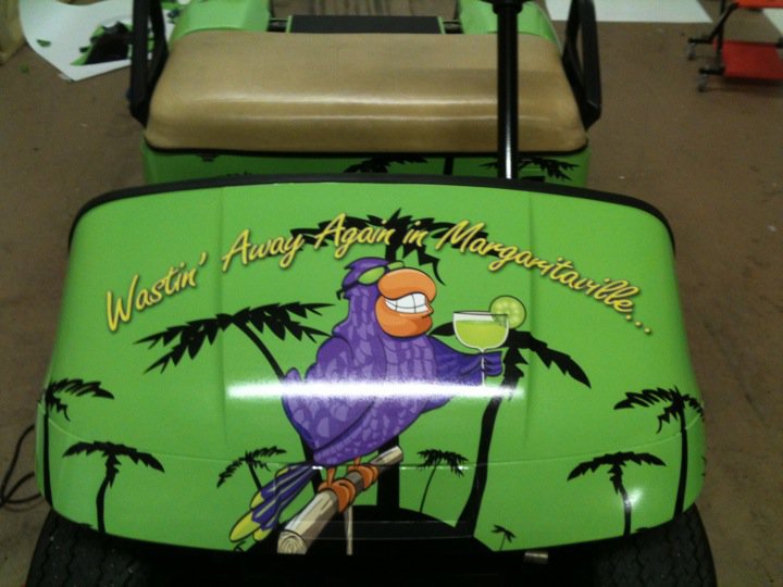

eahicks
Done with IJ180 V3
