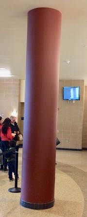

I have a client that wants two pillars wrapped or decorated with graphics from top to bottom. I am hoping someone has had experience wrapping pillars before and can give me some insight on what technique to install the wrap. Pillars are 140" tall and 84" circumference. Would it be best to wrap 3 sheets around the poles starting at the bottom and going to the top in which would make two horizontal seams and a vertical seam? Or would it be better to wrap it in two pieces overlapping going from top to bottom and having 2 vertical overlaps? Poles have a very slight texture on them and I am thinking about using Phototex so they don't pull the paint off when removing. Anyone have any insight, I would sure appreciate your thoughts and ideas.

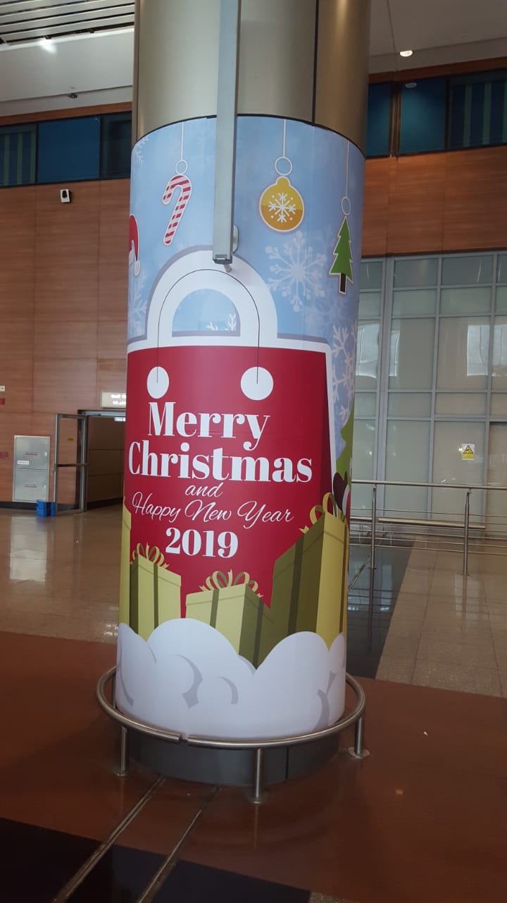

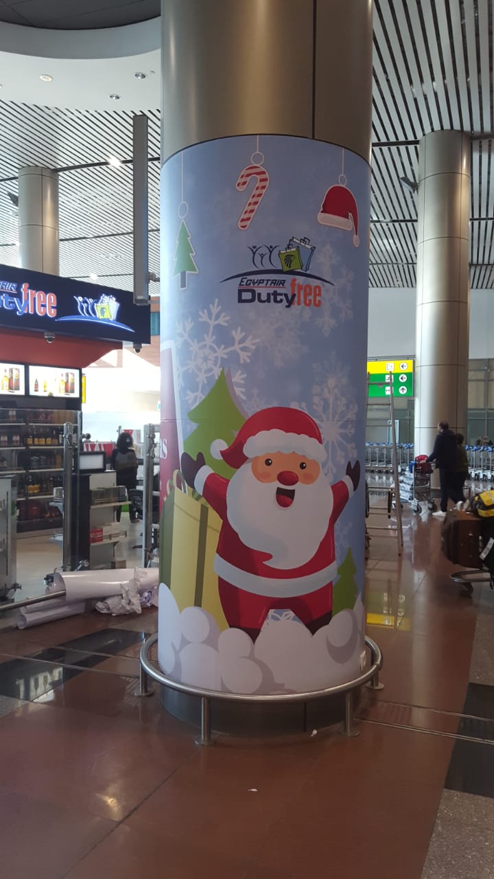

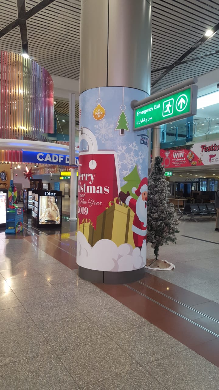

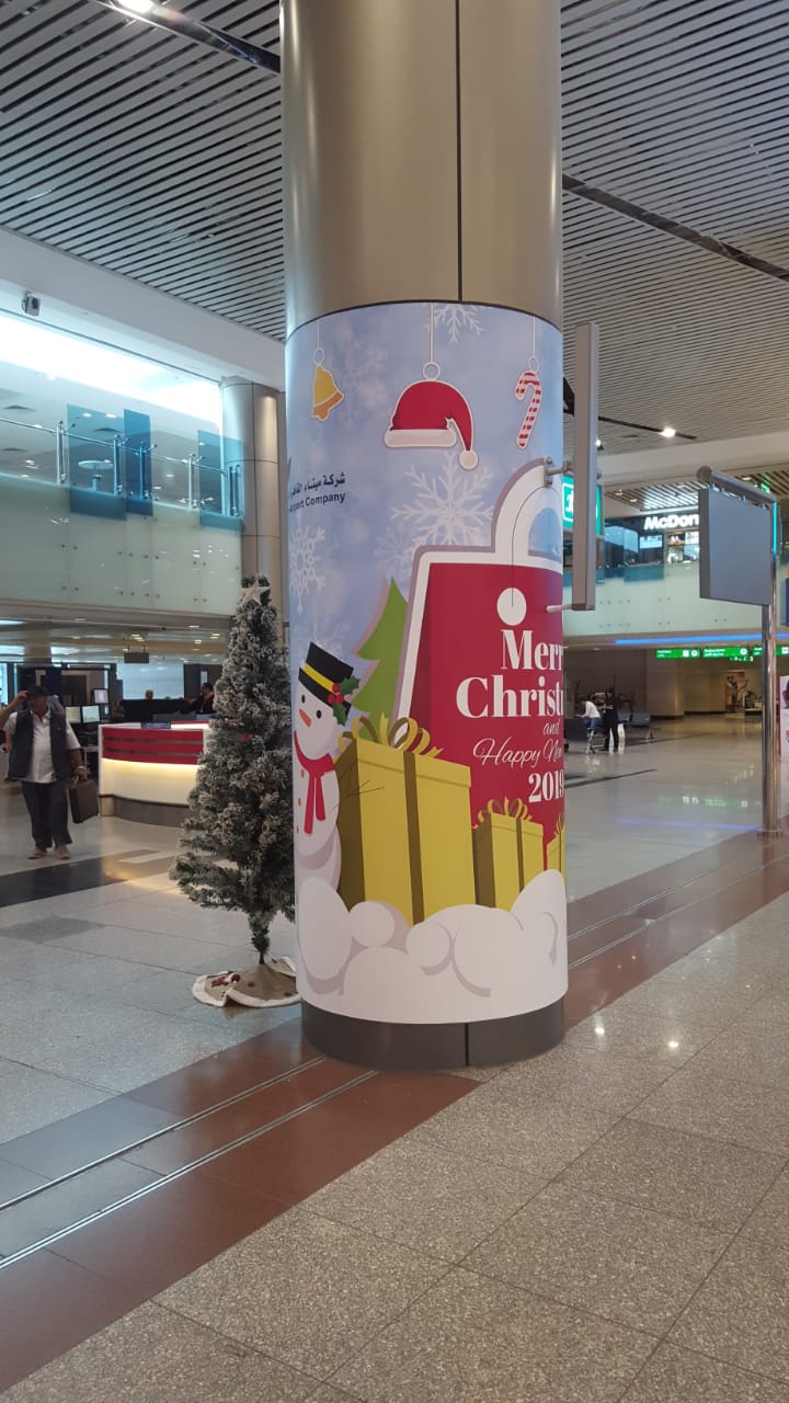

Our method is as follows, print 3 vertical tiles, use a liner cutter and make a 10 cm cut in the middle of the tile vertically, use laser guide to align, fix the tile from the middle first then go side ways, etc.....
