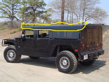

Hello again everyone. I am new to wrapping and all has been going really good as far as the wrapping process but one place i am having issues is around the back of the cab of a truck. For some reason it either takes forever to get it without a wrinkle or crease. Any help would be great. Have a buddy wanting me to do a full/ partial wrap on the rear of his h1 hummer and dont want to mess up on the roll from side to the roof.

I had the same type issue on the truck like this i just wrapped. Yes it is not a hummer and no i didnt think about it when i posted the image lol.. The hummer has the same type of radius from the side to the roof.

you don't need heat to wrap that top corner, nor should you use any. you want to pull the vinyl towards the roof on top and down towards the glass. sort of away from the corner in both directions. you should be able to get it to lay flat on the corner and then work it away from the corner in both directions. at least that is how i do it and have not had any failures yet.

I was referring to the truck not the hummer. The hummer would depend how it was designed. The hummer looks pretty easy. That extrusion I would just work it around onto the roof, going inside the groove not gap and heating it in.

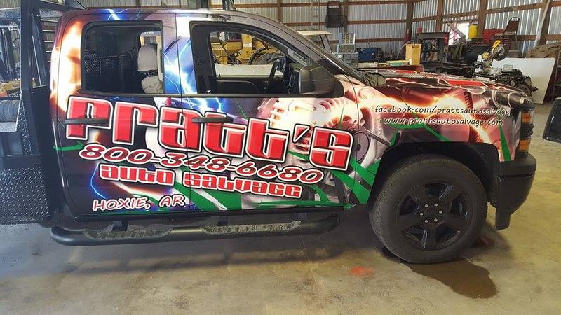

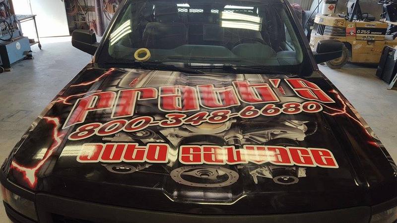

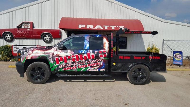

Thanks for all the information everyone. I really do appreciate it. We wrapped a truck that we had here to test with and had not planned on it being the final wrap b/c we needed to learn. Was told to use a overlap rather than a butt type. We did the overlap and i just dont like it but was told that the butt type would separate over time.
Right now there is a seam on the front fender and the door.

We did not wrap the roof on this truck it was 3 panels on the sides of it. On the 14 trucks the area i have outlines is part of the side of the cab and it wraps around the back of the truck to the back glass. Or atleast that is where the body seem is at. I may be wrong.

yeah, I know what you mean. I just pull it tight and work it slowly around the curves, but I do the top corner like i stated earlier, and I do the corner first before getting it to the break in the body.
Also, never, ever do a "butt type" seam.

Your last statement makes me feel much better about my decision but i know i did leave to much of an overlap. What is normal for an overlap?

.5"-1". I usually go less than 1" because I think it looks cleaner. In one instance, I was contacted by a company to do an install and they sent me the wrap with 2" seams. It looked really odd. The seams might bother you but looking at the pictures you can't tell where they are. And nobody is supposed to be inspecting it anyway. I've only had 2 customers complain about seams. Usually informing them that 90% of wraps have them and this is just the way it is when you have something that can't be covered in one panel and to keep your cost down, this is how we do it

Ok. This truck had 2 inch seams but we are not sure this wrap will even stay on it and i honestly screwed up when i did the overlap. I thought when setting the overlap up in my software that when i set it to 2" it meant it would over lap each by 1". So yeah had a head in rear moment lol..Anyone here use bad wraps templates. Was curious b/c all of the templates are angled. I guess it wouldn't matter as long as you angle all of your images and so on to match the angle of the truck. I think this is why a couple of the items on my truck are off like the hoxie and the website. Wonder if it would be easier or look strange if the website and the hoxie we put on over the top of the rest of the background in layers i guess.

You can do it in layers if you are worried about something lining up. I try to keep overlays minimal because I don't want to have to worry about other pieces when I finish a wrap but overall I think they don't look out of place. And don't assume that vinyl will come off without damaging the wrap.
I have used Bad Wrap templates before. They are good for the most part. I usually design in illustrator and use a bad wrap template/picture of the vehicle as an overlay to see if my template is accurate and make adjustments as needed
